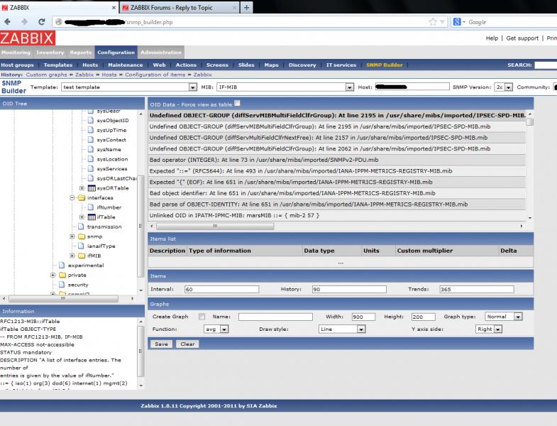

                            But now it's throwing multiple MIB parse errors at me whenever I try to click on a table (ifTable here) and if I click on one of the loaded values, I get another warning:
                            P.S. Clicking on a single OID in the list (like SysDescr) works fine and displays no errors.
                            Installing SNMP Builder is very hard.
                            • kot_vaska
                              • Jan 2012
                              • 13
                              #359
                              Okay, I got it sorted out. Just removed the following MIBs altogether:
                              IPSEC-SPD-MIB
                              IPSEC-SPD-MIB
                              IPATM-IPMC-MIB
                              IANA-IPPM-METRICS-REGISTRY-MIB
                              SNMPv2-PDU
                              Now tables are rendered correctly, however... (I knew this wasn't going to be easy )

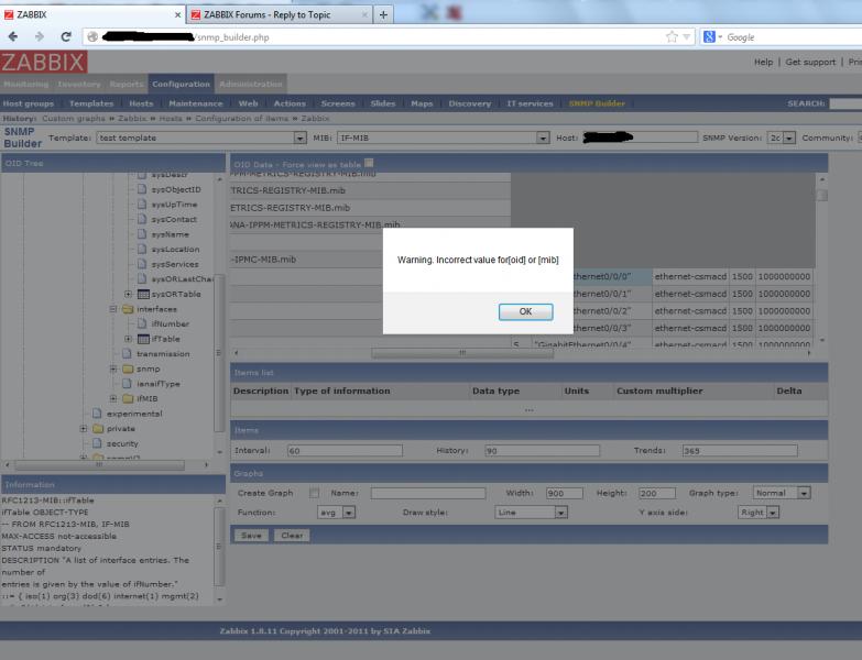

                              The "Save" button does not work. When I click on it, nothing happens (and I make sure to choose an item in the table to save).
                              Any ideas? Gonna check Postgresql log.
                              [Upd]: nothing there...
                              [Upd2]: However I'm getting something in apache logs:
                              ifAdminStatus: Unknown Object Identifier (Sub-id not found: (top) -> ifAdminStatus)
                              Whenever I choose an item in the table to save.
                              [Upd3]: When I try to save SysDescr to a template, nothing is written to the apache log but saving does not occur anyway. So this probably isn't related.
