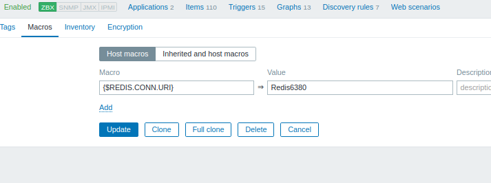

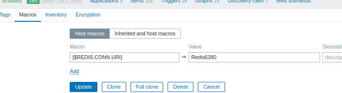

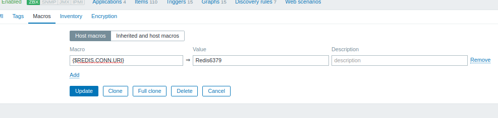

          hi guys, here is my solution.
          For each Redis instance, i just add new host with different host-name on the same real HOST, then i adjust the "{$REDIS.CONN.URI}" macro to match with each instance name which configured in zabbix-agent2.conf.
Name:	Screenshot from 2021-04-19 15-20-19.png
Name:	Screenshot from 2021-04-19 16-04-48.png
Name:	Screenshot from 2021-04-19 15-53-05.png
          Hope this can help you guys.

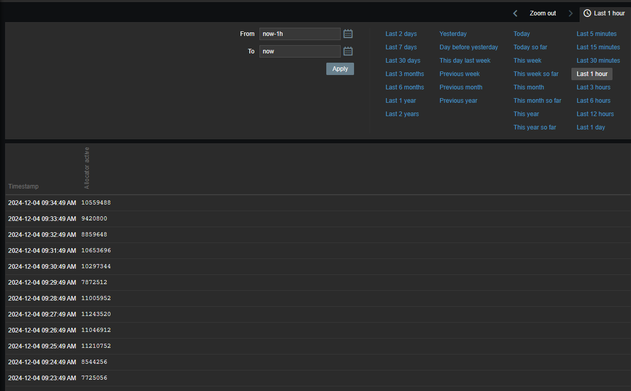

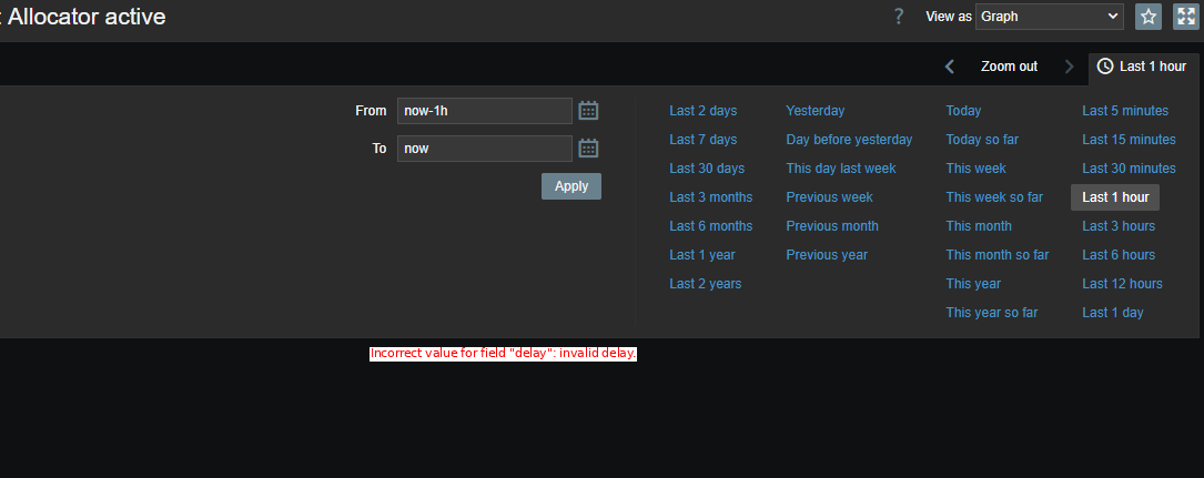

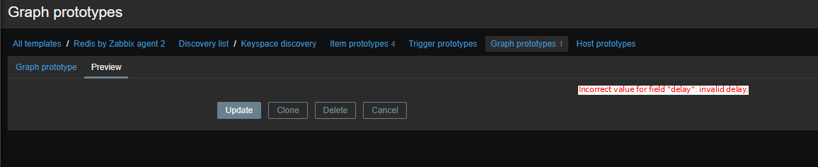

                        Issue with Redis Item Graphs and Errors in Nginx/PHP Logs
                        Zabbix Version: 7.0.2
                        Problem Description:
                        I have configured the Redis template in Zabbix, and data collection works fine. However, when trying to generate any item graph for Redis, I encounter the following error:
                        HTML Code:
                        incorrect value for field delay: invalid delay
                        Additionally, the Nginx logs show the following errors:
                        HTML Code:
                        2024/12/03 11:43:37 [error] 2880636#2880636: *121309647 FastCGI sent in stderr: "PHP message: PHP Warning: Undefined array key "file" in /usr/share/zabbix/include/classes/debug/CProfiler.php on line 374;
                        PHP message: PHP Warning: Undefined array key "line" in /usr/share/zabbix/include/classes/debug/CProfiler.php on line 374;
                        PHP message: PHP Warning: Cannot modify header information - headers already sent in /usr/share/zabbix/include/classes/helpers/CCookieHelper.php on line 54;
                        PHP message: PHP Warning: PHP Request Shutdown: Failed to write session data using user defined save handler. (session.save_path: /var/lib/php/sessions, handler: update_timestamp) in Unknown on line 0"
                        while reading upstream, client: 10.18.140.130, server: zabbix.info, request: "GET /chart.php?from=now-1h&to=now&itemids%5B0%5D=903506&type=0&resolve_mac ros=1&profileIdx=web.item.graph.filter&profileIdx2 =903506&width=1734&height=200&_=wxx0rwj3 HTTP/1.1",
                        upstream: "fastcgi://unix:/var/run/php/php8.2-fpm.sock:", host: "zabbix.info", referrer: "https://zabbix.info/history.php?itemids%5B0%5D=903506&action=showgraph "
                        Steps Taken So Far:
                        1. The Redis template has been checked — data collection is working without errors.
                        2. The issue occurs only when generating graphs.
                        3. PHP configuration: using php8.2-fpm, session.save_path is set correctly.
                        Questions:
                        1. What could be the cause of the error incorrect value for field delay: invalid delay?
                        I would greatly appreciate any advice or troubleshooting steps to resolve this issue.

                        • Satrier
                          • Mar 2023
                          #28
                          my problem fixed https://support.zabbix.com/browse/ZBX-25715
