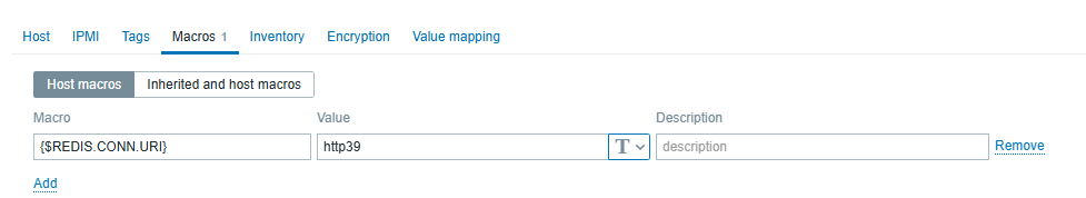

    I use Zabbix Server 7.0 LTS, and now i stucked with the Redis template. I have a simple standalone redis instance which i want to monitor with agent 2 active.
    I have the session config in the plguins/redis.conf:
    Plugins.Redis.Sessions.http39.Uri=tcp://localhost:6379
    And for the host:

    default value for macro {$REDIS.CONN.URI} = "tcp://localhost:6379"
    And it works great. Why change anything?
