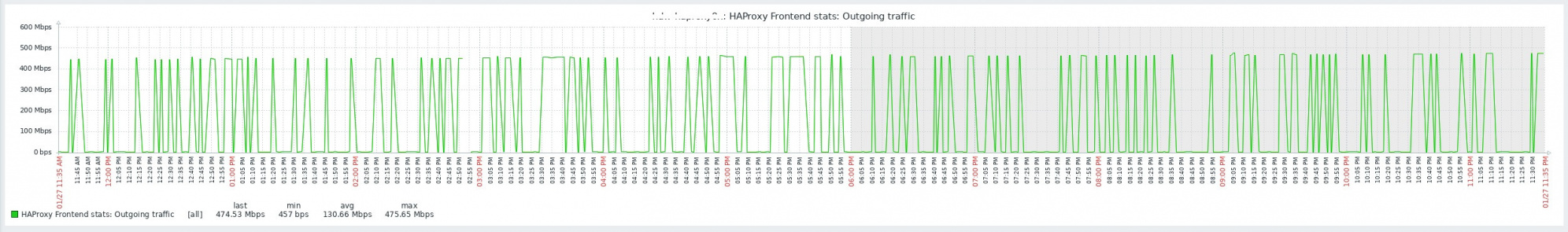

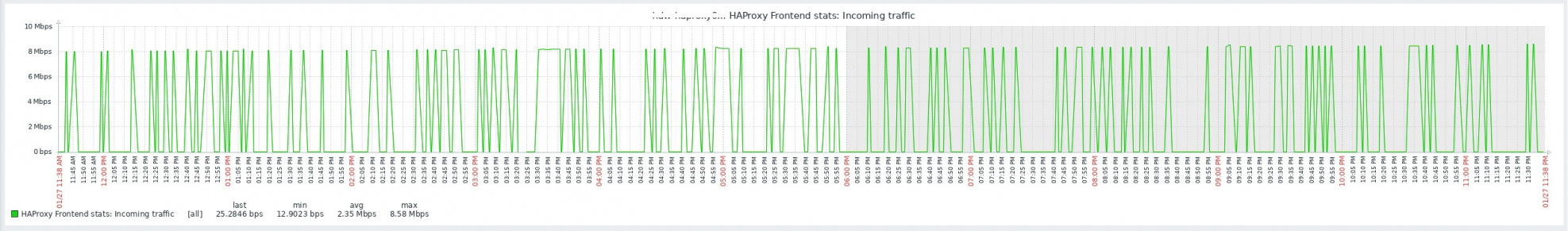

                        Hi everyone
                        We're using Zabbix 5.2.3 and HAProxy 2.2.8-1ppa1. Together with Template App HAProxy by HTTP.
                        Does someone have also issues with the Outgoing Traffic? There is always a very huge «hiccup» between some bps and some hundered Mbps, which cant be, because there is no yet traffic like that (solution is not online/public yet). The Incoing Traffic looks fine. But i did not find any issues on the template.
                        Outgoing
                        Click image for larger version  Name:	haproxy-outgoing.jpg Views:	8 Size:	271.3 KB ID:	417581

                        Incoming
                        Click image for larger version  Name:	haproxy-incoming.jpg Views:	5 Size:	270.6 KB ID:	417582

                         			[TD]7088.5588[/TD]
                         		[/TR]
                        [TR]
                        [TD]01/27/2021 10:48:15 PM[/TD]
                         			[TD]1646.2726[/TD]
                         		[/TR]
                        [TR]
                        [TD]01/27/2021 10:47:15 PM[/TD]
                         			[TD]12.9177[/TD]
                         		[/TR]
                        [TR]
                        [TD]01/27/2021 10:46:15 PM[/TD]
                         			[TD]7099.5954[/TD]
                         		[/TR]
                        [TR]
                        [TD]01/27/2021 10:44:15 PM[/TD]
                         			[TD]8479715.5055[/TD]
                         		[/TR]
                        [TR]
                        [TD]01/27/2021 10:43:15 PM[/TD]
                         			[TD]25.2842[/TD]
                         		[/TR]
                        [TR]
                        [TD]01/27/2021 10:41:15 PM[/TD]
                         			[TD]8488220.8057[/TD]
                         		[/TR]
                        [TR]
                        [TD]01/27/2021 10:40:15 PM[/TD]
                         			[TD]1648.5627[/TD]
                         		[/TR]
                        [TR]
                        [TD]01/27/2021 10:37:15 PM[/TD]
                         			[TD]8471746.5423[/TD]
                         		[/TR]
                        [TR]
                        [TD]01/27/2021 10:35:15 PM[/TD]
                         			[TD]8467368.3828[/TD]
                         		[/TR]
                        [TR]
                        [TD]01/27/2021 10:33:15 PM[/TD]
                         			[TD]8472785.8787[/TD]
                         		[/TR]
                        [TR]
                        [TD]01/27/2021 10:31:15 PM[/TD]
                         			[TD]25.303[/TD]
                         		[/TR]
                        [TR]
                        [TD]01/27/2021 10:30:15 PM[/TD]
                         			[TD]12.9175[/TD]
                         		[/TR]
                        [TR]
                        [TD]01/27/2021 10:29:15 PM[/TD]
                         			[TD]12.9166[/TD]
                         		[/TR]
                        [TR]
                        [TD]01/27/2021 10:28:15 PM[/TD]
                         			[TD]25.2765[/TD]
                         		[/TR]
                        [TR]
                        [TD]01/27/2021 10:27:15 PM[/TD]
                         			[TD]25.3468[/TD]
                         		[/TR]
                        [TR]
                        [TD]01/27/2021 10:26:15 PM[/TD]
                         			[TD]7073.097[/TD]
                         		[/TR]
                        [TR]
                        [TD]01/27/2021 10:24:15 PM[/TD]
                         			[TD]6960.3761[/TD]
                         		[/TR]
                        [TR]
                        [TD]01/27/2021 10:23:15 PM[/TD]
                         			[TD]25.3021[/TD]
                         		[/TR]
                        [TR]
                        [TD]01/27/2021 10:21:15 PM[/TD]
                         			[TD]12.9172[/TD]
                         		[/TR]
                        [TR]
                        [TD]01/27/2021 10:19:15 PM[/TD]
                         			[TD]8450264.9043[/TD]
                         		[/TR]
                        [TR]
                        [TD]01/27/2021 10:18:15 PM[/TD]
                         			[TD]6967.8699[/TD]
                         		[/TR]
                        [TR]
                        [TD]01/27/2021 10:17:15 PM[/TD]
                         			[TD]12.9076[/TD]
                         		[/TR]
                        [TR]
                        [TD]01/27/2021 10:15:15 PM[/TD]
                         			[TD]12.9978[/TD]
                         		[/TR]
                        [TR]
                        [TD]01/27/2021 10:14:15 PM[/TD]
                         			[TD]8706.1207[/TD]
                         		[/TR]
                        [TR]
                        [TD]01/27/2021 10:13:15 PM[/TD]
                         			[TD]25.6843[/TD]
                         		[/TR]
                        [TR]
                        [TD]01/27/2021 10:11:15 PM[/TD]
                         			[TD]8445888.683[/TD]
                         		[/TR]
                        [TR]
                        [TD]01/27/2021 10:10:15 PM[/TD]
                         			[TD]8757.1551[/TD]
                         		[/TR]
                        [TR]
                        [TD]01/27/2021 10:08:15 PM[/TD]
                         			[TD]8444168.0118[/TD]
                         		[/TR]
                        [TR]
                        [TD]01/27/2021 10:07:15 PM[/TD]
                         			[TD]12.9177[/TD]
                         		[/TR]
                        [/TABLE]

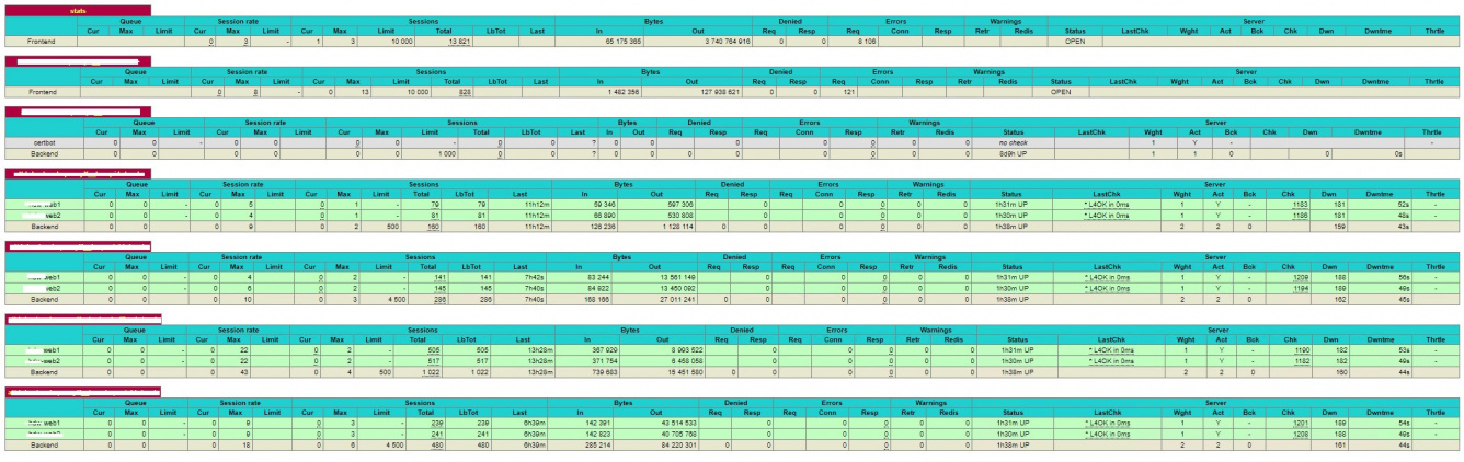

                        HAProxy Stats (UI)
                        Click image for larger version  Name:	haproxy-stats-ui.jpg Views:	4 Size:	319.4 KB ID:	417583
