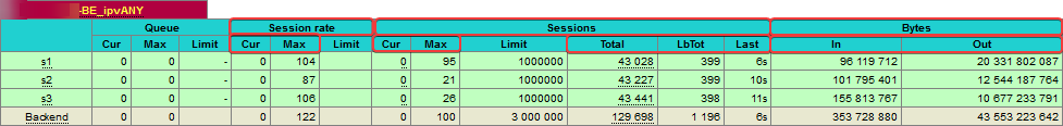

                            I am using Zabbix 4.4.8
                            Any idea why backend(s) session information is not available in the template HAProxy, for example:
                            Session rate(Current|Max)
                            Sessions (Current|Max|Total|LbTot|Last)
                            Bytes (In|Out)
                            It is essential to have these metrics for backend(s).
                            These are available for frontend, but not backend, any idea how I can add these items to "(TCP) backend discovery"
