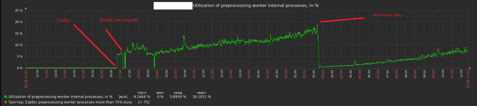

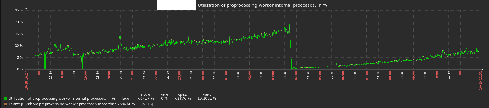

                        Hello , I think I have problems with this template.
                        Zabbix server configuration:
                        8 CPU
                        8GB memory
                        SSD
                        Zabbix 5.2.7
                        zabbix_server.conf
                        LogFile=/var/log/zabbix/zabbix_server.log
                        LogFileSize=0
                        DebugLevel=3
                        PidFile=/var/run/zabbix/zabbix_server.pid
                        SocketDir=/var/run/zabbix
                        DBName=******
                        DBUser=****
                        DBPassword=****
                        StartPreprocessors=8
                        SNMPTrapperFile=/var/log/snmptrap/snmptrap.log
                        ListenIP=0.0.0.0
                        CacheSize=256M
                        Timeout=15
                        AlertScriptsPath=/usr/lib/zabbix/alertscripts
                        ExternalScripts=/usr/lib/zabbix/externalscripts
                        LogSlowQueries=3000
                        StatsAllowedIP=127.0.0.1
                        Before connecting this template, I had 18 connected agents. The parameters "Utilization of preprocessing worker internal processes" and "Utilization of preprocessing manager internal processes" were kept at low values. After I connect a host with this template, the values can rise to 100% in waves. A couple of days ago, I deleted this template and re-imported it from the repository. Also I reinstalled the zabix agent on the host (zabbix-agent.x86_64 5.4.6-1.el7).After that, the maximum load decreased, but it still has a waveform.Perhaps I do not understand something about the work of Zabbix, but could not comment on this behavior.Since raising these parameters to 100% leads to the fact that data from other hosts are no longer processed.
                        Here two hosts connected with this template:
                        After all reinstall zabbix-agent and template i connect only one host for testing the problem:
                        Any help?

                          • trideter
                            trideter commented
                            Hello template, ES: Get nodes stats gets too many values (about 20MB),
                            try replacing {$ELASTICSEARCH.SCHEME}://{HOST.IP}:{$ELASTICSEARCH.PORT}/_nodes/stats
                            with {$ELASTICSEARCH.SCHEME}://{HOST.IP}:{$ ELASTICSEARCH.PORT}/_nodes/stats/jvm,indices,fs (here are the metrics you need), in this case the system will not be loaded so much
                          • psychomoise
                            psychomoise commented
                            There are too many dependant items on the es.nodes.get_stats master item which can be quite big as indicated by @trideter.
                            for more information on the issue you can check this : https://support.zabbix.com/browse/ZBX-21032 and https://support.zabbix.com/browse/ZBX-20590 as this is corresponding in my case to the issue, the preprocessing manager queuing items and one preprocessing worker saturated.
                            to solve the issue:
                            - create two new prototype items in the discovery of the nodes which will be the exact same as es.nodes.get_stats with the following differences:
                            name for the first is "ES {#ES.NODE}: Get node stats (fs,indices,jvm,thread_pool)" and second is "ES {#ES.NODE}: Get node stats (http)"
                            key for the first is "{$ELASTICSEARCH.SCHEME}://{HOST.CONN}:{$ELASTICSEARCH.PORT}/_nodes/{#ES.NODE}/stats/fs,indices,jvm,thread_pool" and second is "{$ELASTICSEARCH.SCHEME}://{HOST.CONN}:{$ELASTICSEARCH.PORT}/_nodes/{#ES.NODE}/stats/http"
                            - modify all the dependant items in the prototype items in the nodes discovery so the master item is now "ES {#ES.NODE}: Get node stats (fs,indices,jvm,thread_pool)"
                            - modify the prototype items "ES {#ES.NODE}: Number of open HTTP connections" and "ES {#ES.NODE}: Rate of HTTP connections opened" so the master item is now "ES {#ES.NODE}: Get node stats (http)"
                            - disable/delete the item "ES: Get nodes stats" which has no purpose now
                            Those changes should lower the load on the preprocesing processes (manager and workers), in my end with 8 cluster monitored with the template, I went down to almost no CPU consumption on the preprocessing processes instead of preprocessing manager saturated (and creating queued items) and 1 preprocessing worker saturated.
                            It could be good if the template is updated that way to solve a lots of performance issues in the future, especially with version 6.0 of Zabbix on which there is a big change in the preprocessing processes.
                            The preprocessing manager is now sending all the dependant of the same master item to the same preprocessing worker. That means if you have hundreds of dependant item linked to the same master item, your preprocessing worker can be completly saturated.
                            The idea to solve this kind of issue :
                            - reduce the number of dependant item for the same master item
                            - reduce the volume of data in the master item so the preprocessing is not processing a big data containing a lots of information not needed.
