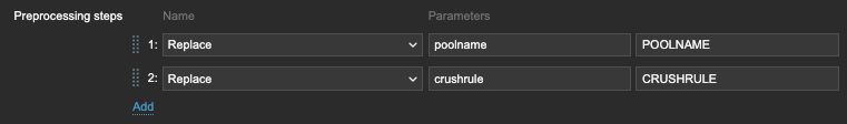

              I mentioned discovery problems in the last post.
              Found the problem, this is due to zabbix-agent2-plugin-ceph returning results in lowercase so the macros don't work.
              Example:
              [root@zabbix ~]# zabbix_get -s cephserver01.net.local -p 10050 -k ceph.pool.discovery[192.168.0.10:3300,zabbix,AAGwiBJCBAAIPQlYTrJpRp7+TgoPblAPTwhbN5==]
              [{"{#poolname}":".mgr","{#crushrule}":"default"},{" {#poolname}":"cephfs_metadata","{#crushrule}" :"default"},{"{#poolname}":"cephfs_data","{#crushrule}":"default"}]
              Just the result in prettier format
              "{#crushrule}": "default",
              "{#poolname}": ".mgr"
              " {#poolname}": "cephfs_metadata",
              "{#poolname}": "cephfs_data"
              The discovery rule tries to find #POOLNAME and #CRUSHRULE but since the output is in lowercase it doesn't match.
              It's simple to fix, att Preprocessing rules to the OSD and Pool discoveries. This makes them work. Example below for the Pool discovery.
