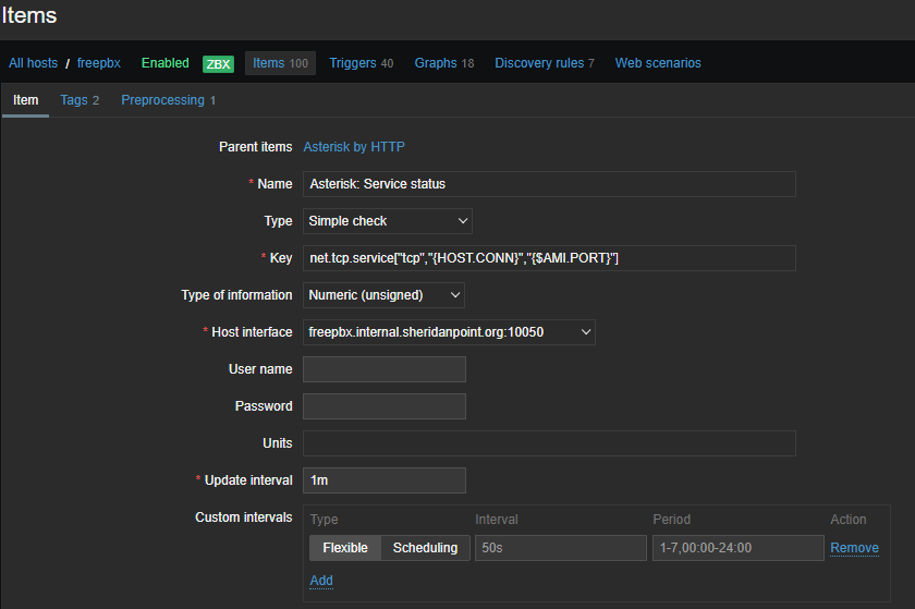

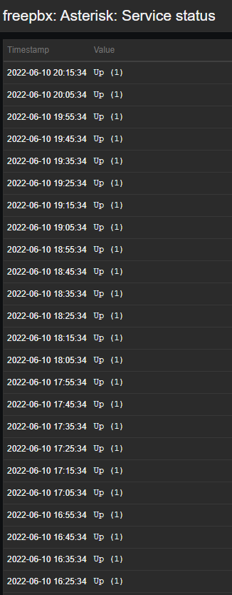

        I am having an issue, where the update interval for Asterisk: Service Status is happening only every 10 minutes, even though the Update interval is set to 1 minute.
        All other items are updating at 1 minute intervals.
        Click image for larger version  Name:	zabbix update interval.png Views:	0 Size:	41.3 KB ID:	446027
Name:	zabbix asterisk service status update interval.png
        I can't figure out why this is.
          Please check the Preprocessing page.
          Markku
          • mrosu
            • Jan 2022
            • 15
            #80
            Markku
            That's what is was, thanks! I'm still learning quite a bit about Zabbix.

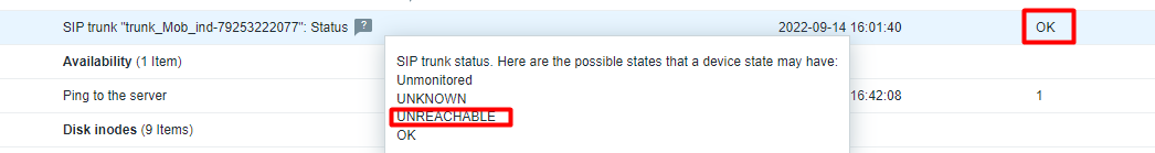

                    Hi all! I'm new to Zabbix and I need your help. Working on the integration Zabbix+FreePBX. Using this template https://www.zabbix.com/ru/integrations/asterisk.
                    My goal is to have "OK" status only if the trunk is "REGISTERED", otherwise it must have "UNREACHABLE".
                    Currently, the trunk with the state "No Authentication" for example has status "OK", while it must be "UNREACHABLE". Could you please help to fix this.

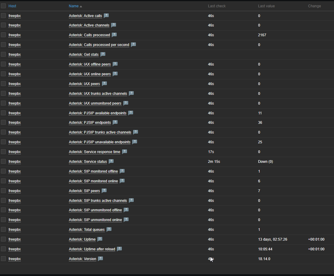

                      After update to Zabbix 6.2, asterisk service is always down on FreepPBX. Not sure what changed. I also updated FreePBX but every other template check is working.
                      Anyone else having this issue?

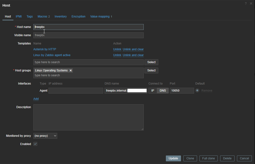

                        Just wanted to add this here to my previous post. Zabbix configuration shows "Invalid third parameter"
                        • mrosu
                          • Jan 2022
                          • 15
                          #87
                          Finally figured it out. Was missing AMI.PORT macro. This template used to work without this or maybe it was configured somehow else.
                          Anyway, I made sure all of the Macros used by this template were configured on the host and it's resolved.

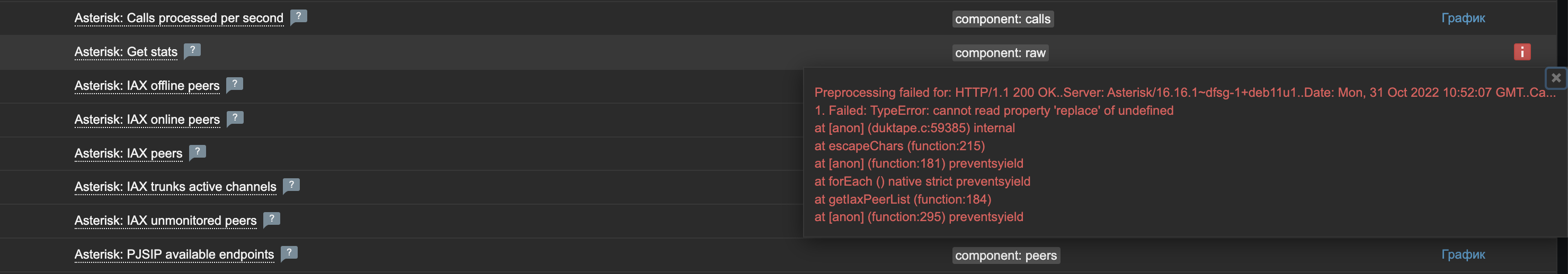

                          • g.mikrykov
                            • Oct 2022
                            #88
                            Hello !
                            I updated Asterisk to version 16.16. and installed FreePBIX.
                            Zabbix stopped receiving data: (pictured)​
                            curl "http://10.0.4.15:8088/rawman?action=login&username=zabbix&secret=zabbix" - works fine !
                            Response: Success
                            Message: Authentication accepted
Name:	Снимок экрана 2022-10-31 в 14.52.45.png
                            ​Please any help
