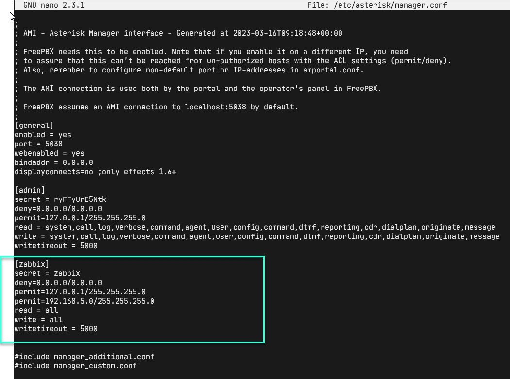

        In addition to enabling the web manager in manager.conf (webenabled=yes) you also need to enable the embedded (mini) http server in http.conf, the bare minimum looks like:
        [general]
        enabled = yes
        bindaddr = <your_asterisk_ipv4>
        Note you will have to update the {$AMI.URL} macro to http://<your_asterisk_ipv4>:8088/rawman because the default prefix is blank.

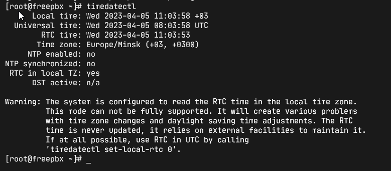

                  Hi everyone, I need help. I'm trying to set up asterisk template and I have a problem "Cannot perform request: Couldn't connect to server"
                  Zabbix-server 192.168.5.5
                  FreePBX 192.168.5.3
                  Zabbix-Server Version is​ 6.2.9
                  I'm using FreePBX-Distro with Asterisk 16
                  Status firewalld on zabbix-server​ inactive
                  Status iptables on freepbx-distro​ inactive
                  timedatectl
                  on Zabbix-server:
                  [root@zabbix62 ~]# timedatectl
                                 Local time: Wed 2023-04-05 11:17:27 +03
                             Universal time: Wed 2023-04-05 08:17:27 UTC
                                   RTC time: Wed 2023-04-05 08:17:24
                                  Time zone: Europe/Minsk (+03, +0300)
                  System clock synchronized: no
                                NTP service: n/a
                            RTC in local TZ: no​
                  on FreePBX-Distro:
                  [root@freepbx ~]# timedatectl
                        Local time: Wed 2023-04-05 11:03:58 +03
                    Universal time: Wed 2023-04-05 08:03:58 UTC
                          RTC time: Wed 2023-04-05 11:03:53
                       NTP enabled: no
                  NTP synchronized: no
                   RTC in local TZ: yes
                        DST active: n/a
                  Warning: The system is configured to read the RTC time in the local time zone.
                           This mode can not be fully supported. It will create various problems
                           with time zone changes and daylight saving time adjustments. The RTC
                           time is never updated, it relies on external facilities to maintain it.
                           If at all possible, use RTC in UTC by calling
                           'timedatectl set-local-rtc 0'.​
                  /etc/asterisk/manager.conf

                  [root@zabbix62 ~]# telnet 192.168.5.3 5038
                  Trying 192.168.5.3...
                  Connected to 192.168.5.3.
                  Escape character is '^]'.
                  Asterisk Call Manager/5.0.3​

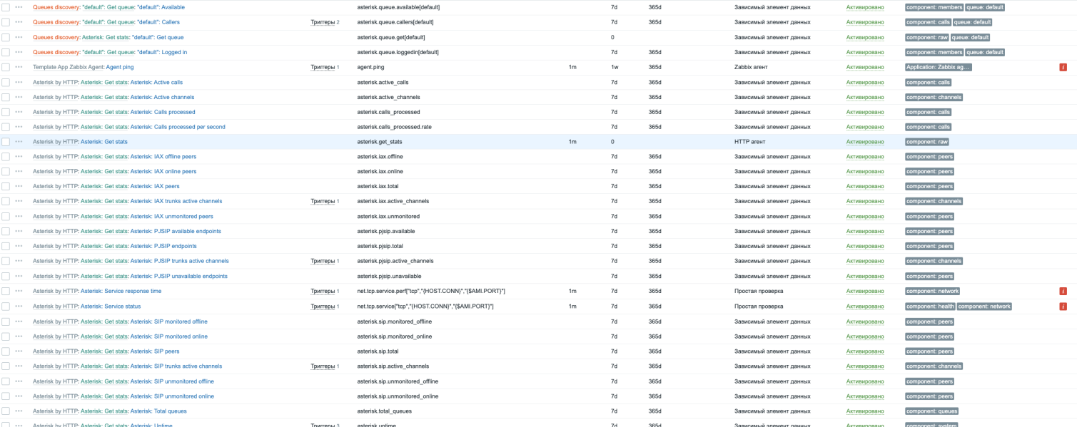

                          Hello everyone, does anyone use the official template template_tel_asterisk_http.yaml? I set it up with freepbx, I get data but I need to get the IAX trunk status. The manual says that Discovery should work but it doesn't work for me and I don't see any errors. What should I do? Does Discovery work for anyone?
                          I have 38 item and they work but new ones don't appear.
                          This XML file does not appear to have any style information associated with it. The document tree is shown below.

                          I receive data from freepbx correctly
