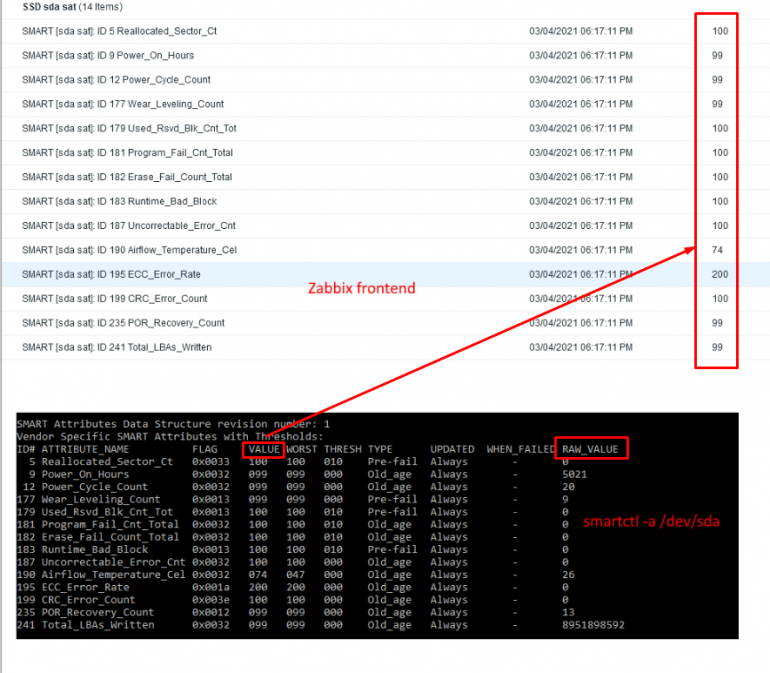

    Hi. Help, tell me how can I see RAW_VALUE?
    TY.
    Originally posted by sirbusby
    I added in /etc/sudoers
    zabbix ALL=(ALL) NOPASSWD:/usr/sbin/smartctl
    and it works
    From Zabbix Server
    zabbix_get -s 192.168.20.141 -p 10050 -k smart.disk.discovery
    [{"{#NAME}":"sda sat","{#DISKTYPE}":"SSD","{#MODEL}":"Samsung SSD 860 EVO 500GB","{#SN}":"S4FNNF0N140769M"}]
    But in last value displayed VALUE, Instead of RAW_VALUE.
              TY.
              I ran in to this as well and figured out how to fix it.
              There is two options.
              Option 1:
              Modify the existing item to use raw value instead
              Consequence: the triggers will then most likely not work and should be removed or disabled since they depend on comparing the threshold against the normalized value and not the raw value.
              Option 2:
              Add a new item in addition to the existing one, this gives you some duplication but preserves the triggers intact.
              This is what i decided to do.
              Open up the template "Template Module SMART by Zabbix agent 2"
              go to Discovery rules and click on "Attribute discovery"
              go to "item prototpypes"
              you should have only one here, open it and click on clone.
              Change the name, i decided on: "SMART [{#NAME}]: ID {#ID} {#ATTRNAME} (raw value)"
              Change the key so it is different than the previous one: i went for: smart.disk.rawvalue[{#NAME},{#ID}]
              Go to preprocessing and change the JSONPath to: $[?(@.disk_name=='{#NAME}')].ata_smart_attributes.table[?(@.id=={#ID})].raw.value.first()
              (basically replacing "value" with "raw.value")
              While in the template you may want to also fix the broken power on hours so it makes sense:
              go back to the template itself again and open up "Disk discovery" instead, find the item prototype for power on hours.
              on preprocessing tab, add a step: "Custom multiplier" and set it to 3600
              This will convert the hours in to seconds as expected by this item, so then it will be displayed properly.
              There still is something else that needs fixing, the graphs have significant gaps in them, haven't investigated this yet

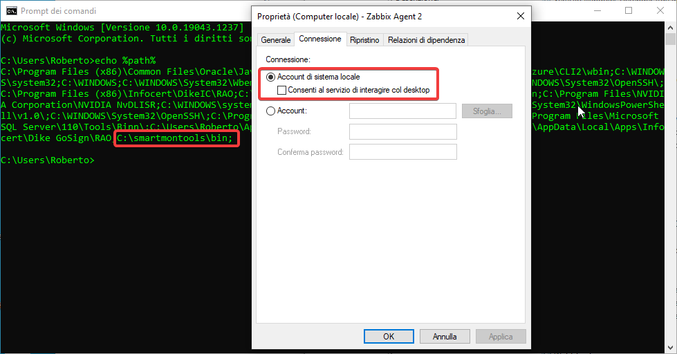

                  • robsitz
                    • Jan 2021
                    #24
                    Hi max.ch.88
                    first of all thanks for your support.
                    My Windows 10 Pro account (username Roberto) is a member of local Administrators group.
                    As you can see in the picture below I already have the path of smartctl.exe into my environment variable PATH as well as Zabbix Agent 2 service is running with Local System account.
                    Then, Zabbix Agent 2 configuration file has commented lines for every Plugins.Smart
                    ### Option: Plugins.Smart.Timeout
                    # The maximum time in seconds for waiting before smartctl execution is terminated.
                    # The timeout is for a single smartctl command line execution.
                    # Mandatory: no
                    # Range: 1-30
                    # Default: <Global timeout>
                    # Plugins.Smart.Timeout=
                    ### Option: Plugins.Smart.Path
                    # Path to smartctl executable.
                    # Mandatory: no
                    # Default: smartctl
                    # Plugins.Smart.Path=
                    Where am I wrong?
                    Thank you in advance for any further support.
                    Regards
                    RS
                    • bcnx
                      bcnx commented
                      Hi Rob, things started working for me when I had the ZAbbix Agent 2 run by Administrator instead of the system account.

                          Hello robsitz
                          Please, set Plugins.Smart.Path="c:\smartmontools\bin\smartctl. exe" in your zabbix-agent2 config file and reboot the service.
                          • robsitz
                            • Jan 2021
                            #29
                            Originally posted by max.ch.88
                            Hello robsitz
                            Hi max.ch.88
                            thanks for your reply!
                            A little bit step forward...I suppose.
                            After I have executed your instructions I cannot see anymore the error "Failed to scan for devices..."
                            The final question is: how can I check within Zabbix if SMART by Zabbix agent active 2 template is working correctly?
                            Thank you in advance.
                            Regards
                            RS
                            • max.ch.88
                              • Oct 2018
                              • 206
                              #30
                              Regards
                              RS
                              If you don't have any unsupported items or LLD errors, the template works correctly.
