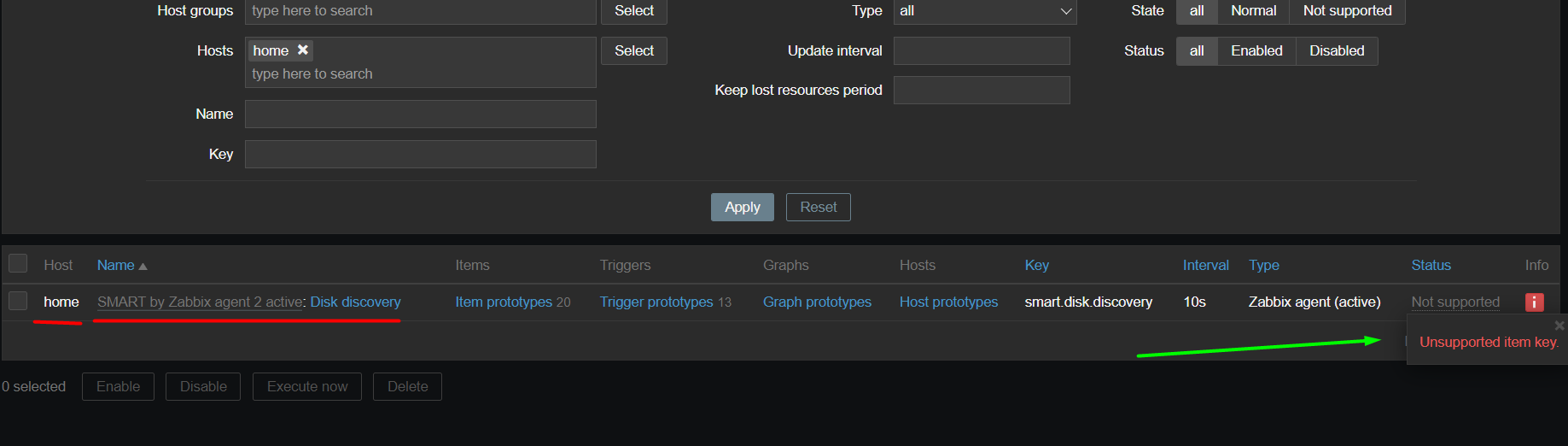

                  Hello all
                  A have host "Windows 10" :
                  --- zabbix agent (Active). Version: "zabbix_agentd Win64 (service) (Zabbix) 6.2.3". Location "C:\monitoring\zabbix\zabbix_agent.conf".
                  --- Smart tool "smartmontools". Version: "smartctl 7.3 2022-02-28 r5338 [x86_64-w64-mingw32-w10-21H2] (sf-7.3-1)". Location: "C:\Program Files\smartmontools\bin\smartctl.exe".
                  zabbix agent config:
                  LogFile=c:\monitoring\zabbix\zabbix_agentd.log
                  DebugLevel=3
                  LogFileSize=1
                  StartAgents=0
                  ServerActive=178.151.*.*:*
                  Hostname=home
                  RefreshActiveChecks=61
                  Timeout=30
                  I added a host to the zabbix server, but I get an error:
                  zabbix_agent.log
                    7364:20221016:074123.806 Starting Zabbix Agent [home]. Zabbix 6.2.3 (revision 98ee88fc19d).
                    7364:20221016:074123.807 **** Enabled features ****
                    7364:20221016:074123.807 IPv6 support:          YES
                    7364:20221016:074123.807 TLS support:           YES
                    7364:20221016:074123.808 **************************
                    7364:20221016:074123.808 using configuration file: C:\monitoring\zabbix\zabbix_agent.conf
                    7364:20221016:074124.251 agent #0 started [main process]
                   14892:20221016:074124.252 agent #1 started [collector]
                   16404:20221016:074124.252 agent #2 started [active checks #1]
                   16404:20221016:074138.565 active check "smart.disk.discovery" is not supported: Unsupported item key.
                   16404:20221016:074148.857 active check "smart.disk.discovery" is not supported: Unsupported item key.
                   16404:20221016:074158.991 active check "smart.disk.discovery" is not supported: Unsupported item key.
                   16404:20221016:074208.097 active check "smart.disk.discovery" is not supported: Unsupported item key.​
                  what am I doing wrong?

                    Switch from zabbix-agentd to zabbix-agent2 , and it should work. I ran into the same problem. Use Zabbix Agent 2

                                I'm having this same problem with version 5.2.7. On couple of Ubuntu 20.04 computers, SMART monitoring works well, but on one computer, I receive this error. All of them use the same 5.2.7 version of agent. They all are behind proxys.
                                When I issue this on local (problematic) computer's shell, the response is as it should be.
                                zabbix_get -s localhost -p 10050 -k smart.disk.discovery
                                [{"{#NAME}":"sda sat","{#DISKTYPE}":"HDD","{#MODEL}":"WDC WD2500BEVT-00A23T0","{#SN}":"WD-WX91A6043599"}]
