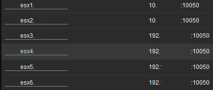

    I have installed the latest zabbix version and I imported my first vCenter. The discovery found my hypervisors, but for some, it wrote the wrong IP in the interface section, causing the hypervisor to appear as down.
    Backgound: My ESXi Hosts have three VMKernel Ports:
    vmk0: reachable from the outside but used for nothing else
    vmk1: vMotion
    vmk2: MGMT (non routed private IP address not accessible via anything but the hypervisors).
    I found that all of them had vmk0 and 2 with Management enabled, even the one where the IP was discovered correctly. I have since disabled this, and only enabled Management for vmk2. I then deleted the hosts and waited for a new discovery but no change. Host 1 had the correct address, Host 2 did not.

    If you are using 5.2.4 and have the same situation as the problem at the URL below, it should be improved in the next version.
    ZBX-19624 : Wrong ip detection for vmware HV in case of multiple instances of management interfaces
