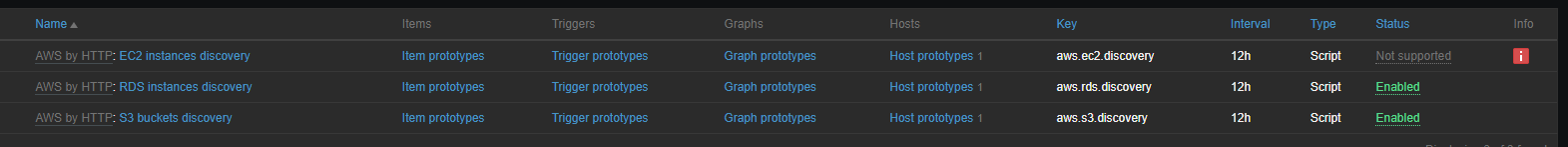

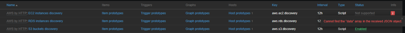

    We are using AWS by HTTP template (version: '6.2' date: '2022-08-29T03:55:47Z'​). It has 3 Discovery Rules, RDS and S3 are working fine but in EC2 we get the following error:
    Cannot find the "data" array in the received JSON object.
    {"error":"Failed response parse. Check debug log for more information."}.
    If we check the variable "response" after being converted in JavaScript by return JSON.parse(response) it has all the data, but something happens after being coverted.... or we are't doing something correctly .
    Here are some screenshots:
