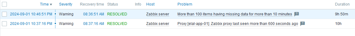

              • ysus
                • Mar 2016
                • 104
                Not sure if I fully understood the problem but Zabbix server monitors proxy health automatically. No additional configuration required.
