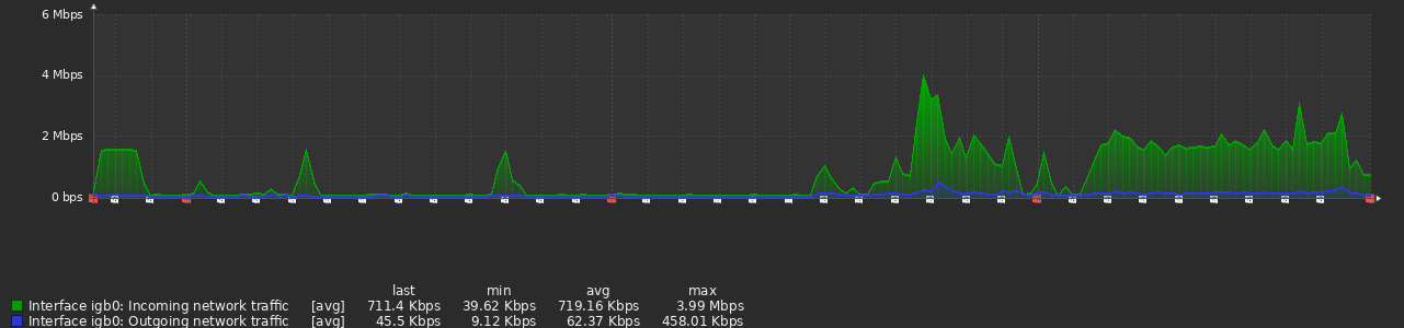

    After upgrading to zabbix 7.0.1 to 7.0.2, my graph time intervals not showing again. This is making it difficult challenging my ISP when there's down time from their end. Below are the images.
    Any help?

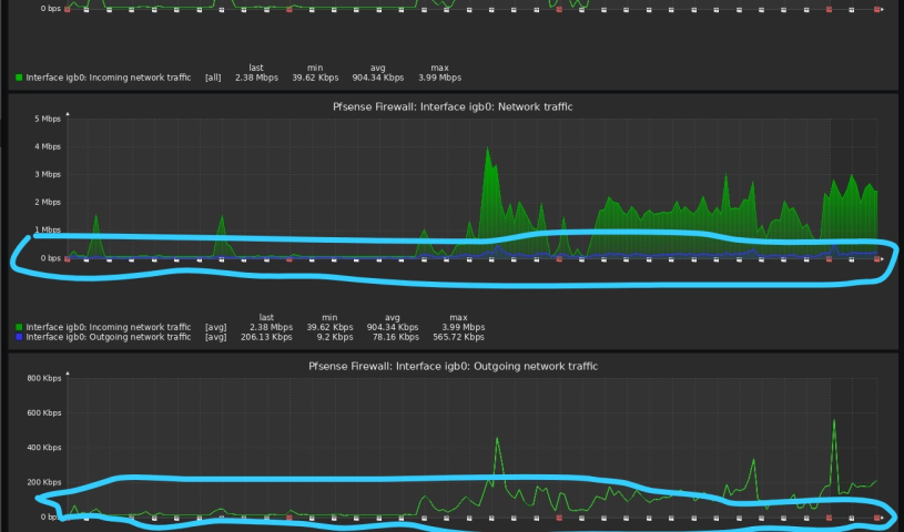

    Hello, I have upgraded recently from 5.4 to 7.0.2. Everything is working fine, however I have the same issue as snetgh. The X axis shows only dots, but not time values. I have tried reinstalling the front end but the issue still persists. I use also Ubuntu Server 24.04 with PHP 8.3.

    Hi Snetgh, I just tried what you suggested, but unfortunately still don't have the timeline values in graphs. Here is what I did:
    - I completely removed PHP: sudo apt remove --purge php*
    - I reinstalled PHP8.2: sudi apt install php8.2
    - Then I reinstalled all required PHP extensions for Zabbix, in version 8.2
    - Then I reinstalled Zabbix front-end (notice that it installs several PHP 8.3 extensions!)
    - Then changed php.ini values to fit the required for zabbix front-end to work properly
    - Finally restarted apache service
    After all this, if I check my computer it says I am on PHP 8.2:
    root@ticsvzabbix:~# php -v
    PHP 8.2.23 (cli) (built: Aug 30 2024 09:22:17) (NTS)
    Copyright (c) The PHP Group
    Zend Engine v4.2.23, Copyright (c) Zend Technologies
    with Zend OPcache v8.2.23, Copyright (c), by Zend Technologies
    Then, when accessing the front-end for the first time, I get the welcome config screen. After going thru it, I access my dashboard. If I check on any graph I can see issues with the timeline as I had before:
    Am I missing something?
    Thanks,
    Jordi​

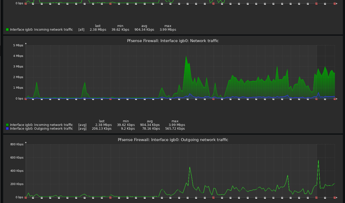

        Hi everyone, I have the same problem too:
        Configuration: Ubuntu Server 24.04, php8.3-fpm, Apache2
        I've tried everything, but the result remains the same.​
