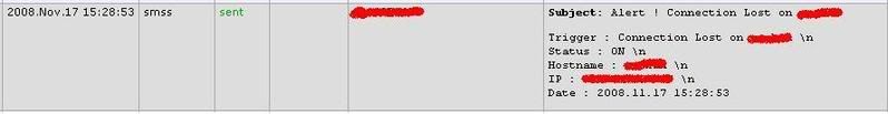

    Media Type : Script (SMS bash script not executed)
    i've created bash script for sending sms...
    the script is running if i execute it from command shell.
    but zabbix won't execute it (or maybe execute but not functioning)
    this is the script
    filename : smsalert
    #!/bin/bash
    /usr/bin/gsmsendsms -d /dev/ttyS0 -b 115200 $1 "Sub:$2 -------- ------- Msg:$3 (Zabbix SMS Alert)"
    no error is recorded

        • al-siput
          • Jun 2008
          • 12
          Calimero :
          i just type the file name (refer attached pics before)
          What if you add some "echo I am here >> /tmp/sms.log" in you script ?
          I guess you double checked permissions ?
          it's working...
          only the sending sms part is not working...
