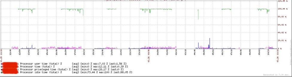

    I use Zabbix 1.6 (upgrade from 1.4) on ubuntu server with mysql database and since I install zabbix (before the upgrade) I have a problem.
    My problem is that regularly I have interruption on my graphics and nothing in the logs:
    I don't know why there are these interruptions, if anybody have idea..

    How many hosts are you monitoring? Items?
    I've ran into this problem when my database was getting a beating from way too much data coming in...
    zabbix_server, PHP frontend, MySQL were all running on the same Pentium4 server, at about 30 hosts I had graphs similar to yours
    Solution was to get a dedicated powerfull MySQL server (dual core Xeon), installing it from source
    What also helped was to disable some items that we didn't 'need'
    Hope this helps

        I still have the same problem with graphs
        I return to you because I still have the same problem however I use Zabbix with 2 server. One for the application and the other for the mysql database.
        Sometimes, there is "hole" in my graph although I still have data.
        I check the server and he is not overload, so is it possible that there is a specific configuration for the graphs??

                But, it is very strange, the hole appears at the same moment on all my graphics...

                          This hole appears with SNMP, zabbix active, and zabbix [passive], items? The hole for all of the various items is exactly the same?

                            I am seeing the same issue here on a fresh 1.6.2 setup:
                            Zabbix app server - Ubuntu 8.0.4, DL380
                            Zabbix MySql server - Ubuntu 8.0.4, ML530
                            Number of hosts 3
                            Number of items 195
                            Number of triggers 73
                            Number of users 1
                            Required server performance, new values per second 7.0544 -
                            The memory_limit was at the default setting of 16M, I bumped it up to 64M.
                            I also tweaked the my.cnf settings as follows:
                            # * Fine Tuning
                            key_buffer              = 1500M
                            max_allowed_packet      = 16M
                            thread_stack            = 128K
                            thread_cache_size       = 8
                            #max_connections        = 100
                            table_cache             = 1800
                            #thread_concurrency     = 10
                            # * Query Cache Configuration
                            query_cache_limit       = 100M
                            query_cache_size        = 99M
                            Restarted everything. let it run for a few hours and am still seeing the gaps in the graphs. This is a 1 day view, but the gaps all the way to the right are reflective with the new changes in place. Bummer.

                              Yes, it is exactly the same on all my graphics.
                              So, with memory_limits=128M in php.ini, I still have the "hole".
                              So, I give you some precisions about zabbix architecture:
                              Zabbix application server: Ubuntu server 8.10, IBM xseries 335, 4Go RAM
                              Zabbix Mysql server: Ubuntu server 8.10, IBM netfinity 6000R, 8Go RAM
                              Hosts: 172
                              Items: 2295
                              triggers: 831
                              Required server performance, new values per second: 56.376
                              I check and none of Zabbix server appears overload.
