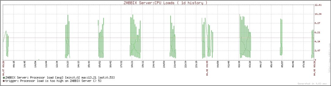

                      Hi all,
                      I come back because I still have the same problem even worst...
                      But now, the hole is not the same on all the graph.
                      The only change since the last time is an upgrade to 1.6.4.
                      is there an other way to use the graphs or an specific configuration.
                      Thanks for your help.
                      • alucard95
                        • Sep 2008
                        • 38
                        #26
                        new information
                        If I change the time history, for example 6 hours I obtain this:
                        maybe the problem is with the refresh...

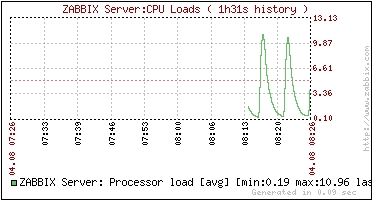

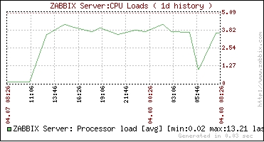

                          I have the exact same problem as you and have been trying to solve it for going on 2 weeks now, with no luck. (Ubuntu 8.0.4)
                          And this being a fresh (stock) install of 1.6.4 with no imports and only 2 hosts being monitored - the Zabbix App server and the Zabbix DB server
                          Administration --> Queue shows there are 80+ items in the "More than 10 minutes" queue.
                          The problem appears to be that the "next check" (If you click on 'details' for the queue) is more than 2 hours behind the current time.
                          The date/time on my Zabbix servers is correct, including the hardware clock. My date.timezone in php.ini is correct.
                          The graphs are just baffling in their rendering behavior. The below screenshots are of the very same graph.
                          -The first one is a 1 hour view
                          -The second one to the right is simply a change to one day view
                          -The thrid one is also the one day view, but clicked on to get full size graph.
