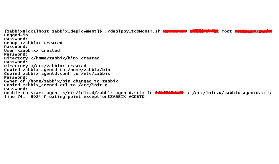

      We are using zabbix-1.6.3 version. Kindly see the attached file.
      The Client server (which we need to monitor) is SuSE Linux server.
      Every steps its asking password when it creats group, user,directory and atlast it gives error-
      Unable to start agent </etc/init.d/zabbix_agentd.ctl> in a.b.c.d : /etc/init.d/zabbix_agentd.ctl: line 74: 21501 Floating point exception$ZABBIX_AGENTD

        I don't see a problem with zabbix here. Looks like you have issues with your linux distro. You should learn how to use ssh and start zabbix manually because your init scripts appear to be broken.
