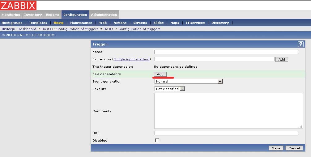

    • Davidus
      • Dec 2010
      • 281
      How about trigger dependencies?
      Wouldn’t it be better solution?

        • Davidus
          • Dec 2010
          • 281
          Originally posted by mbconn
          Can you explain a bit how that works - I understand adding the dependencies in the trigger but it's not clear to me what the trigger expression should be?
          Being honest I don’t know much about trigger dependencies
          little bit information can be found on following link
          http://www.zabbix.com/documentation/...r_dependencies
          If I`m not mistaken you have to set up two triggers
          First trigger - "Template_My_Generic:Server unreachable via {$PRIMARY}"
          Second trigger - "Template_My_Generic:Server unreachable via {$SECONDARY}"
          or whatever your triggers are
          After you done add first trigger to second as an dependency
          Once again I`m not sure... I`m just taking a guess on how it can be possibly done
          • mbconn
            • May 2011
            • 14
            thanks again D
            that would seem to make sense but my tests haven't been successful. I added the second trigger to the first as a dependency then used the first as the basis of the action. However, when only the first trigger is true the action is kicked off, i.e. {$PRIMARY} is down but {$SECONDARY} is still up. The only way I've got it to work properly is as described above.
            • Davidus
              • Dec 2010
              • 281
              Wired, that had to work
              Try to do following
              A trigger depends on trigger B
              Trigger B depends on trigger A
              and let me know what happens
