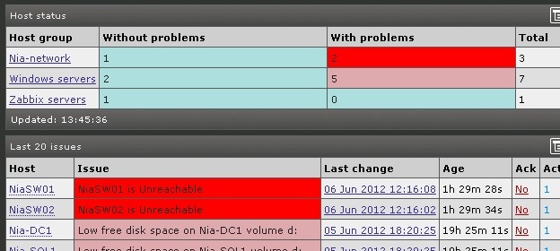

    Attached is a screenshot of some of the items on the template as well as the errors reported in zabbix.
    The issue is most likely a configuration problem on the zabbix end since this is my first time setting up zabbix and since I've had snmp based monitoring of the same switches up and running before with some other software.

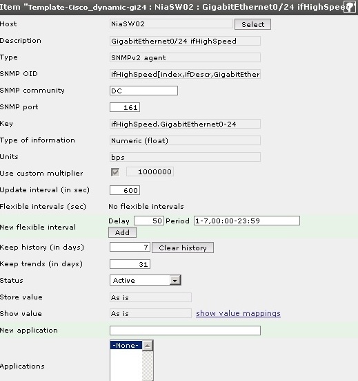

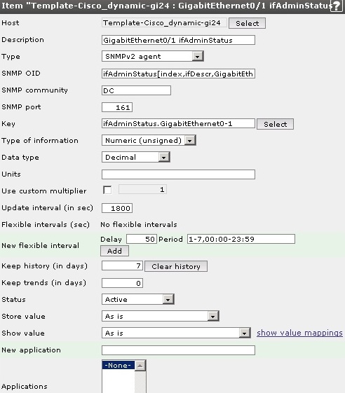

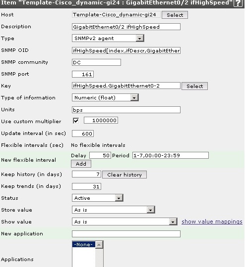

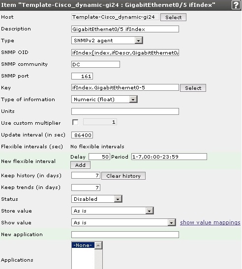

    More item examples
    Here 2 more item examples.

          SNMP can be tricky.
          Are you sure the description for the ports are "GigabitEthernet1-0" in your switch ?
          you can try snmpwalking ifDescr on your switch, and update accordingly the snmp OID in the template if the description don't match...
