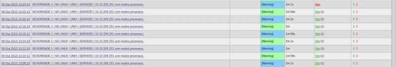

    Can somebody help me? My trigger hysteresis not working. I have one trigger how below. I am using macros on the triggers.
    (({TRIGGER.VALUE}=0) & ({Template OS Linux:proc.num[].last(600)} > {$CPU_LOAD})) |  (({TRIGGER.VALUE}=1) & ({Template OS Linux:proc.num[].last(600)} < {$CPU_LOAD}))
    This is a trigger result in the events tab.
    (({TRIGGER.VALUE}=0) & ({SERVER2:proc.num[].last(600)} > 400)) | (({TRIGGER.VALUE}=1) & ({SERVER2:proc.num[].last(600)} < 400))
    Events:

    You have quite a few problems with your trigger expression.
    1. .last(600) evaluates a single data point 10 minutes ago.
    2. proc.num[] isn't CPU LOAD, but it may be related
    3. remove the first {TRIGGER.VALUE}=0, because that would cause the flapping
    4. swap your single CPU_LOAD macro for CPU_LOAD_HIGH and CPU_LOAD_NORMAL macros, so that you don't immediately release the trigger
    For example our trigger for high CPU usage is something like the following:
    {host:system.cpu.loadpercentagepercpu.avg5.min(3m)}>95|({TRIGGER.VALUE}=1 & {host:system.cpu.loadpercentagecpu.avg5.max(5m)}>60)
    Which means that it will only trigger when the CPU load per core was higher than 95% at every data point for the last 3 minutes.
    The trigger would only go into an OK state once the CPU load per core is 60% or lower for every single data point for the last 5 minutes. Please take note that the "system.cpu.loadpercentagecpu.avg5" item is a calculated one that we created from:
    last("system.cpu.load[,avg5]")/last("system.cpu.num")
    I hope this helps!
