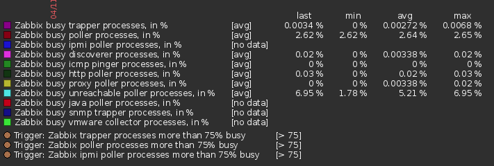

    Please take a look how the zabbix server performs on data gathering proccess:
    Also take a look on "Zabbix Server performance" graph.

      Took a look at graphs you prompted and I see that there is no performance issues (zabbix server performs on data gathering process).
