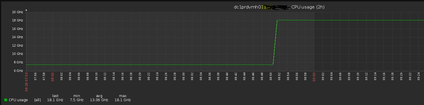

    Hi guys, I have added a VMware VCenter Server to our Zabbix 3.4.8 appliance for monitoring. The server was successfully added and all underlying clusters and hosts were discovered a required. The issue I am having is that some stats like CPU usage and Memory usage for the discoverd ESXi hosts don't seem to update as per attached screenshots. Other stats like network usage appear to update and fluctuate as expected.
    Anyone have any info as to why this might be occurring ?
    Trev

        We are collecting data for 11 ESXi hosts so I have updated StartVMwareCollectors to 22 and restarted Zabbix server but still no accurate CPU and memory data as per attached screen shot.
