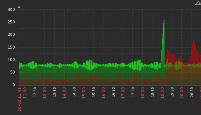

    Hi All,
    yesterday I upgraded my Zabbix server to 4.0 version. After the upgrade, I have a high number of items in queue.
    I tried to use more StartPollers but the situation not change. I am using zabbix agent in active mode.
    Do I need to change some stuff in the server configuration?
    Thanks a lot

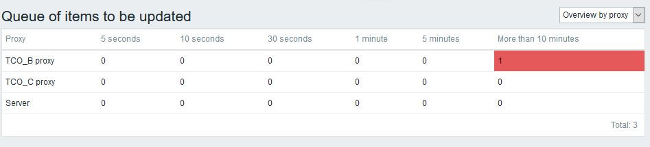

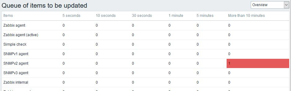

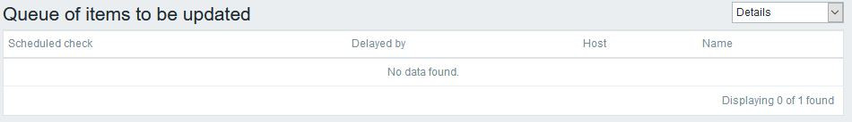

                          I also noticed that issue since upgrade ZBX 3.4 to 4.0.5.
                          The only way to fix this is to force check by selecting related items and clicking 'check now'.
                          Indeed, I had the "Problem: More than 100 items having missing data for more than 10 minutes"....
                          After that, I still have only one item in queue, but when I click on details : => No data found.
                          • TwiX
                            • Mar 2019
                            Here are the screenshots.
