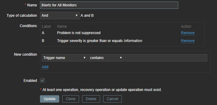

    Can you please provide action conditions screenshot?
ID:	373303Click image for larger version
      Still have the same issue with 4.0.3.
      Server was in maintenance mode at night, C: drive dropped bellow 10%, when maintenance mode ended alerts were not sent out. There was no such issue with 3.0.x.

          Please tell me the settings in the Operations tab of the action settings. Specifically, is the “Pause operations for suppressed problems” checked?
          • rnalrd
            • Jun 2015
            • 9
            Found the culprit: need to remove condition Problem is not suppressed. Pause operations for suppressed problems option (Operations tab) it's enough to delay notifications after maintenance period has ended, if the problem is not resolved.
