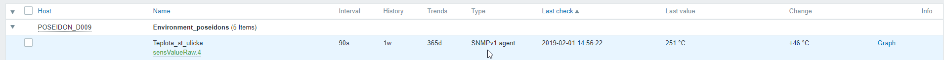

    i am reading values from temperature sensor connected to Poseidon model 4002.
    But snmp value is integer not with decimal point.
    There are 3 numbers for example 225 = 22.5 °C.
    I need write right expression under trigger which will show right values to my zabbix, not 225 °C but 22.5 °C.

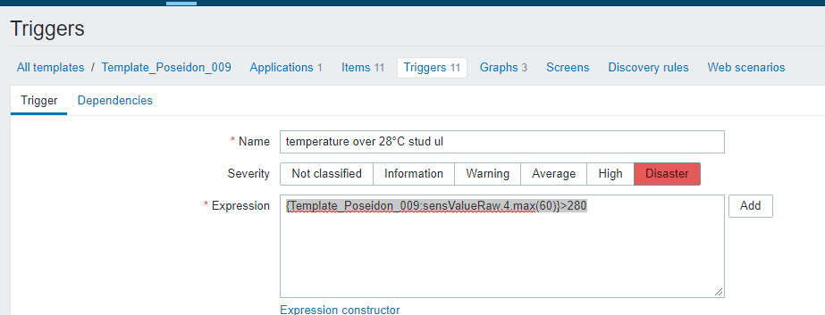

    My actual expression which is showed in atachment is:
    {Template_Poseidon_009:sensValueRaw.4.max(60)}>280

    And finally, yes, you can use division in the trigger statement to divide by 10. Alternatively, just multiple the trigger temperature by ten and enter that as the trigger value.

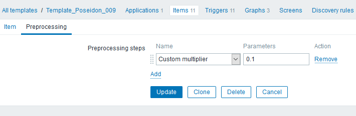

      Chain which helps of right sollution is this too - https://www.zabbix.com/forum/zabbix-...ide-item-value
      You have to add 0.1 number to configuration/hosts/yourHost/item/bookmark - Preprocessing/as name click - custom multiplier and fill parameter 0.1 (attachment)
