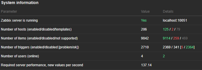

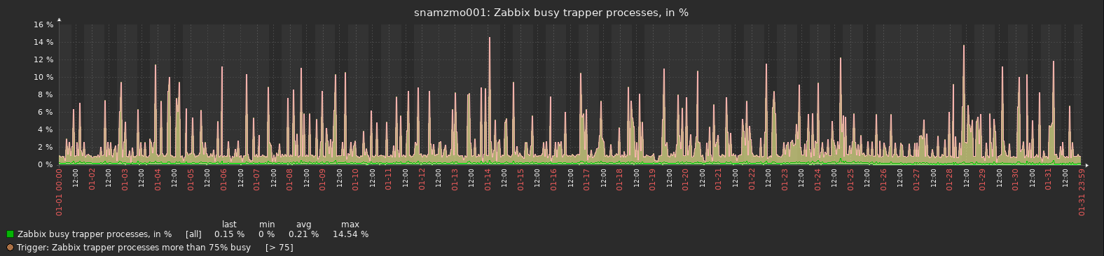

I have around 200 server clients on my Zabbix 3.4 system. but only one I'm having an issue with .
the problem is although the server is up Zabbix keeps reporting that its "agent is Unavailable for 5 Min" then the problem resolves it self. Then after about 3 or 4 minuets the same errors happens again
