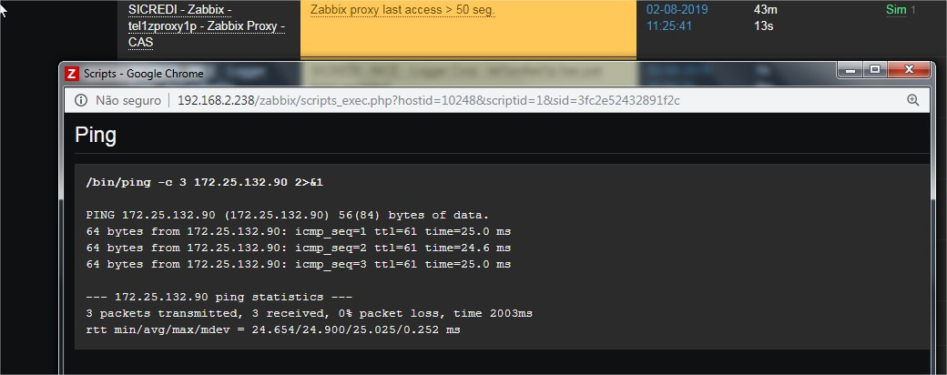

      And another problem I'm having is that the triggers reporting the last proxy access are alarming, but ping responds.
Name:	Last access proxy.jpg
      Follows trigger setting: {tel1zproxy1p:zabbix[proxy,{HOST.HOST},lastaccess].fuzzytime(50)}=0 I believe the problems I am having with the alarms are also due to the problem reported by the log in the first post.

                      SourceIP is usually not needed. Remove it unless you have a reason to keep it, in which case please correct it. And correct the Server parameter if that is not correct, in the screenshot it is apparently 192.168.2.238.
