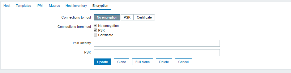

    if you have configured "psk" in "TLSAccept" and "TLSPSKIedntity" in the zabbix-agent.conf file?. Have you also done this in the zabbix-server.conf?
    and (more importantly) have you configured this in the host profile? - image example included

      ThePejnMan commented
      Yes, in conf file everything is set up correctly.
      In host profile I had selected "Connections to host - psk" and "Connections from host - psk." Does it have to have No encryption in "to host" and no encryption to host + psk in "from host" if I want to connect with PSK setted up? I mean I tried it and the ZBX was green but does it then you the PSK connection?

    ThePejnMan - The screenshot I sent wasn't the best example I could have used.

          15440:20190822:102832.558 In send_buffer() host:'XXXXX' port:10051 entries:6/100
          15440:20190822:102832.559 send_buffer() now:1566462512 lastsent:1566462512 now-lastsent:0 BufferSend:5; will not send now
          15440:20190822:102832.559 End of send_buffer():SUCCEED
          15440:20190822:102832.559 buffer: new element 6
          15440:20190822:102832.560 End of process_value():SUCCEED
          15440:20190822:102832.560 In need_meta_update() key:system.swap.size[,total]
          15440:20190822:102832.561 End of need_meta_update():FAIL
          1884:20190822:102833.490 In collect_perfstat()
          1884:20190822:102833.493 End of collect_perfstat()
          1884:20190822:102834.494 In collect_perfstat()
          1884:20190822:102834.497 End of collect_perfstat()
          • ThePejnMan
            • Aug 2019
            By the way the end of log is goint continuously but with interval of 1 sec.
            • the.monitor
              Zabbix Certified Specialist
              • Aug 2019
              • 22
              Okay this is good! Everything looks fine from this end.
              I can see that the Agent is receiving a set of checks from the server, and is running the perfmon keys successfully then sending the data to zabbix server. Successfully.
              There doesn't seem to be a TLS error from what I can see.
              Check the zabbix server logs?
              • ThePejnMan
                • Aug 2019
                I was able to fix it with help of a colleague. The button is still red but it actually logs everything we need(mistake in IP and templates). Also is it easy to set up more than one agent? I heart that you just need each config for each agent and then install it and run it?
