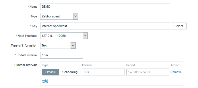

    The next step was to to setup an item. As you might guess from the actual UserParameter, the output I get is in JSON format so I'm going to do some preprocessing to get real values.....
Name:	Annotation 2019-12-02 232413.png
    So nothing too contentious there.

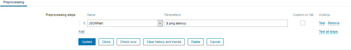

    As far as preprocessing goes, I'm trying to keep it simple;
Name:	Annotation 2019-12-02 232413-2.png
