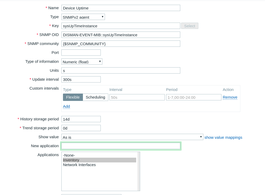

I'm trying the monitore Ruckus ZD1200 ,
I did find the OID for the uptime , however when I configure the item in Zabbix the result is not correct:
- The result using snmpget is : DISMAN-EVENT-MIB::sysUpTimeInstance = Timeticks: (888500157) 102 days, 20:03:21.57
- The result with Zabbix is : 10284 days, 01:39:41
(see attachments: My Item configuration)
Any idea about the issue?
Thank you

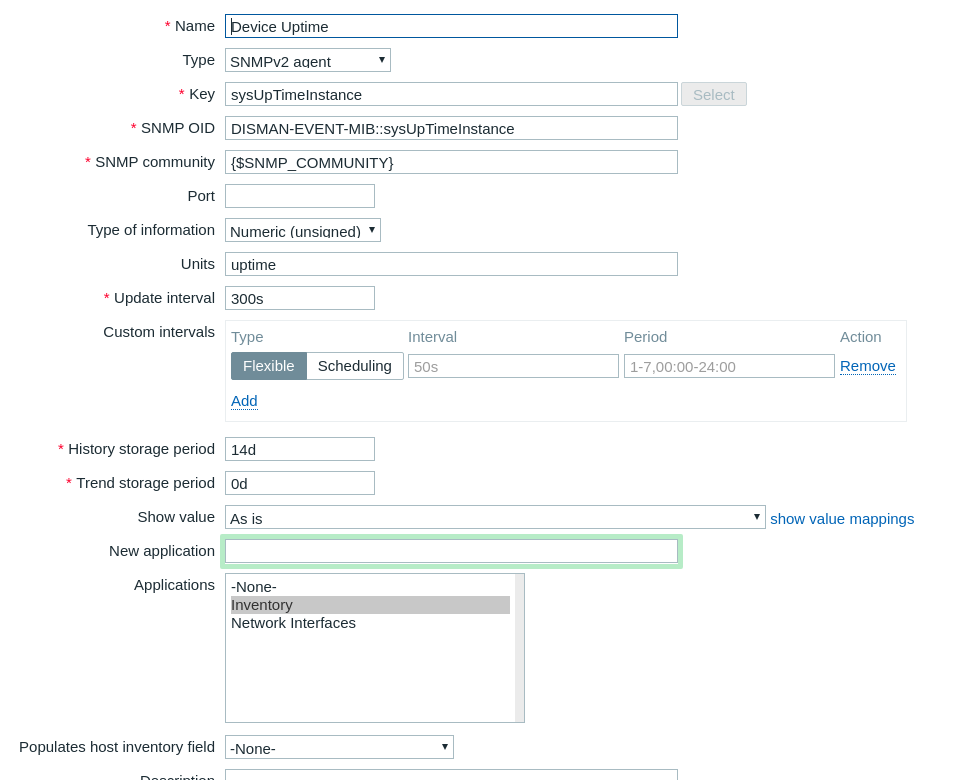

Thank you
