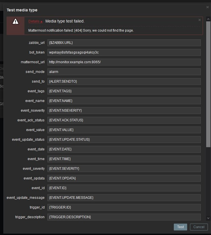

    I am struggling with this documentation.
    I installed zabbix from your documentation, everything is running smoothly with the installed and already loving it. It is so easy to interact and setup is straight forward.
    I used this documentation (https://git.zabbix.com/projects/ZBX/...dia/mattermost) to integrate Zabbix with Mattermost for event notification. I've done every single step correctly (i deleted everything 3 times and did from scratch)
    When I test, I get the following error:
    • Mattermost notification failed: [404] Sorry, we could not find the page.
    I would appreciate if you could help me debug this.
    Thank you

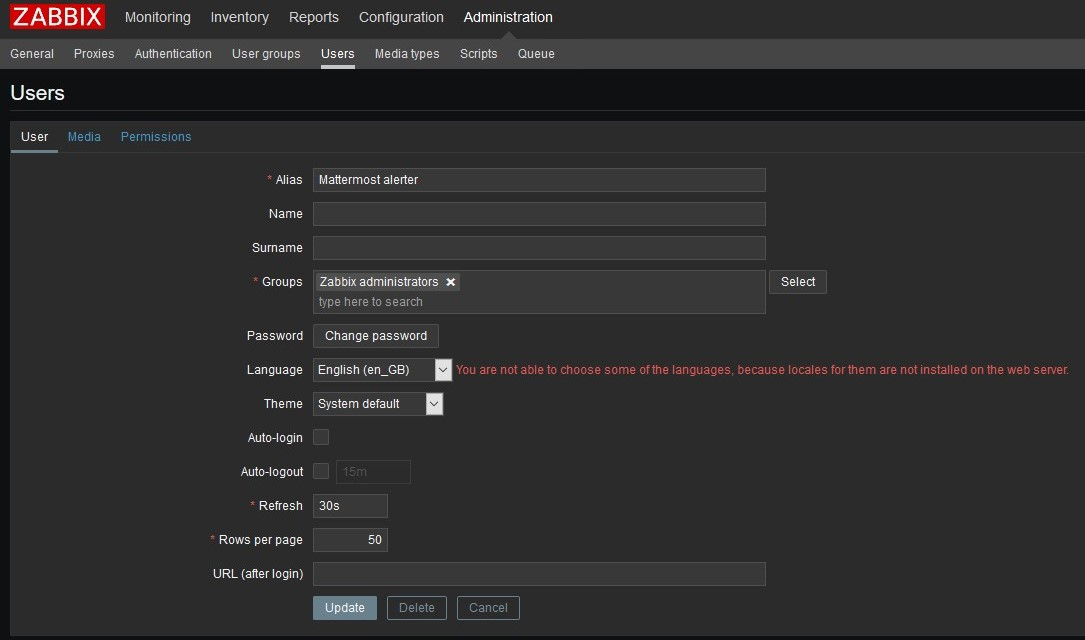

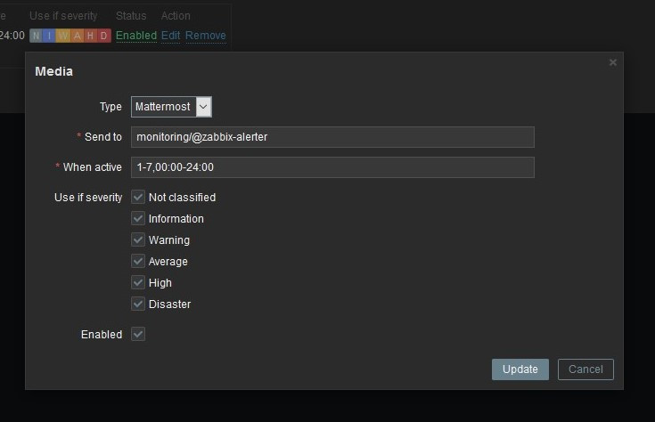

    I'm also stuck at this point. Don't know where the problem is. I hope, someone can give a hint where to take a deeper look....
    My mattermost-server ist on the same host like zabbix.
    I followed everythin from the doku, and maybe the URL is wrong? See attached screenshots an hopefully someone see my mistake....

          In the documentation there is one step they forgot to remark. You have to ensure that the group where you put your new user have read permissions, at least.
          And if you want to make a "Test media type" you have to modify the "send_to" cell value with your channel name, username (within Mattermost) or channel ID. If you do that the test will be succesfull.
