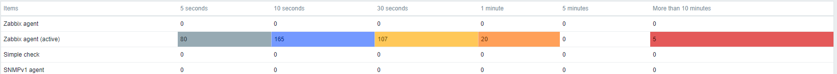

    I have problem with delayed items. I have trigger with .nodata function for one of items and trigger still switch ON/OFF. When I check last data time of this item, there is delay (+- 10 min).

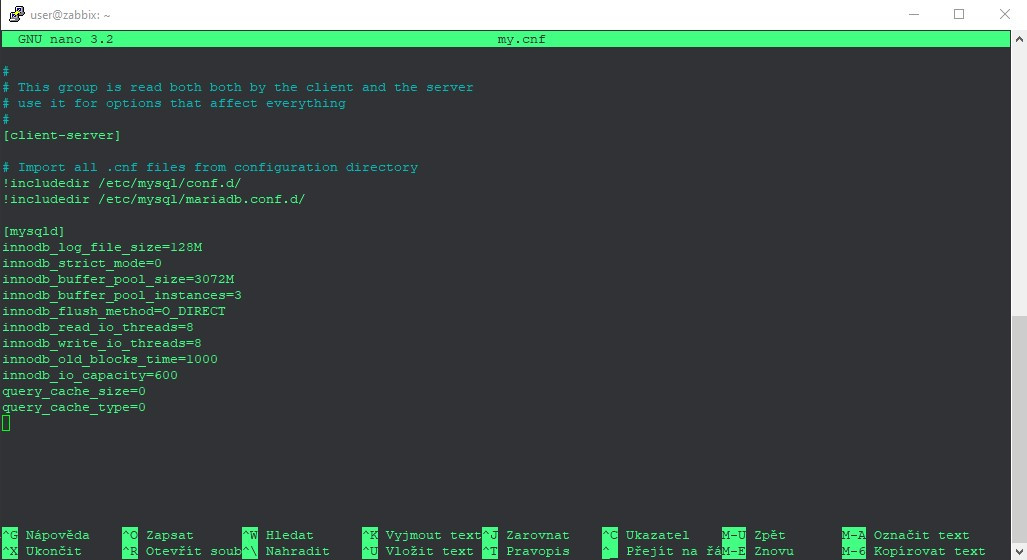

    I browsed for some solution so I edit some parameters in my.cnf file, but i don´t see any changes and I don´t know if my settings is good.

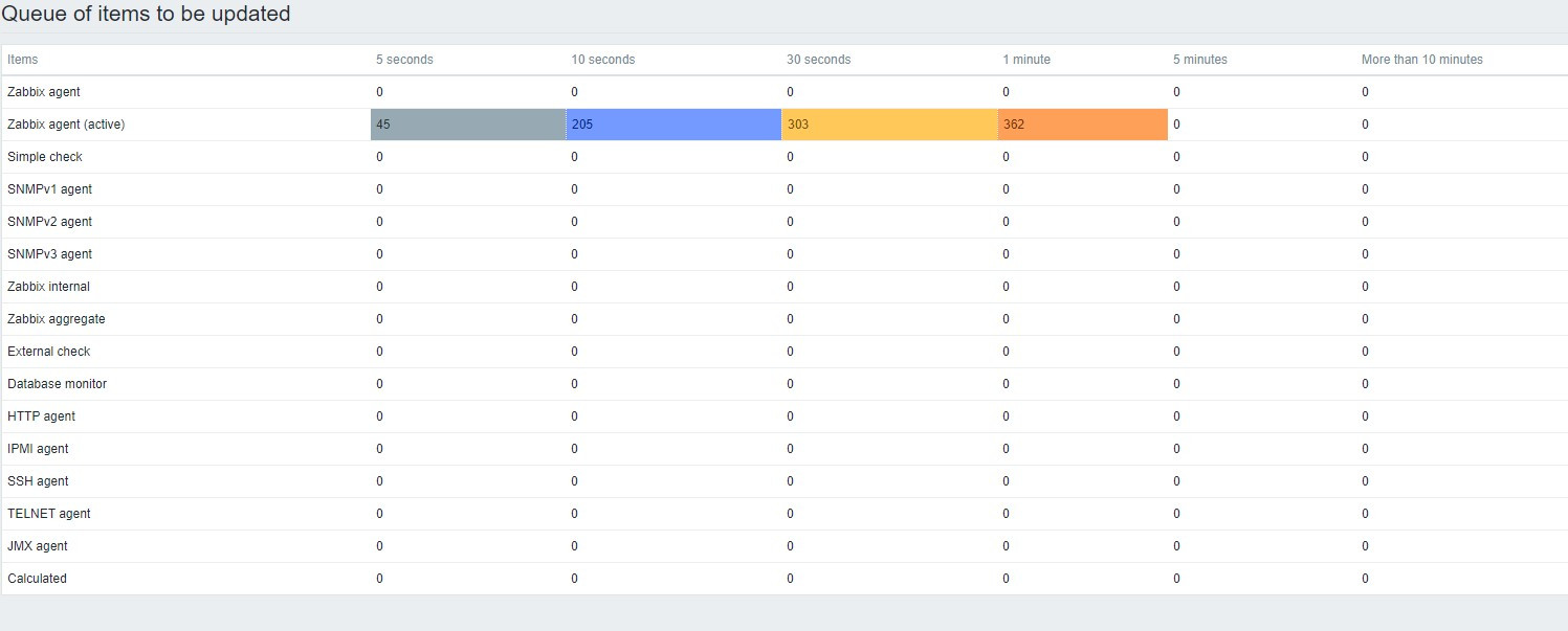

    I have too many queued items. Is it normally? (Picture in attachment)

    In the queues page, see the Details option in the dropdown menu on the upper right, maybe that gives you more insight what's happening.

      in details option I see only check which is delay and how long. I don´t know how can I diagnostic problem with this information.

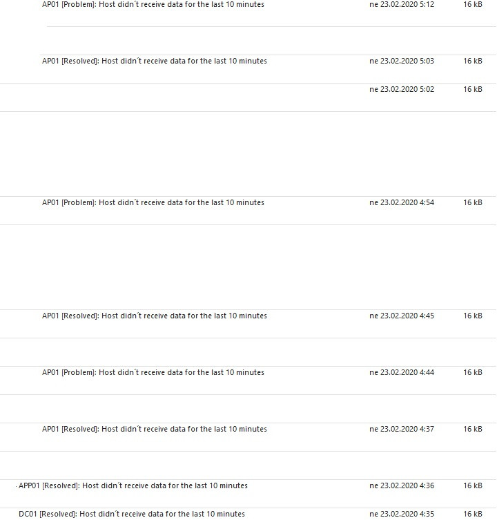

      For me, it´s big problem because after night I have many e-mails (problems/resolved) with information that host didn´t recieve data.

          When you check my image with DB configuration - do you think everything is good?

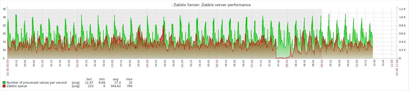

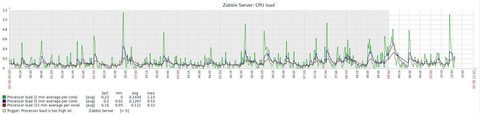

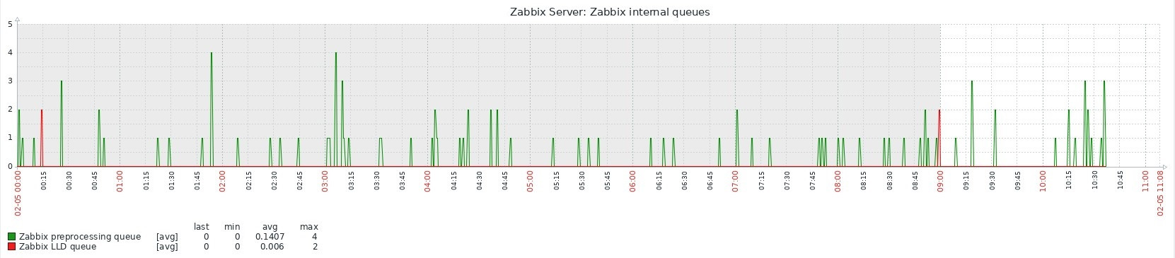

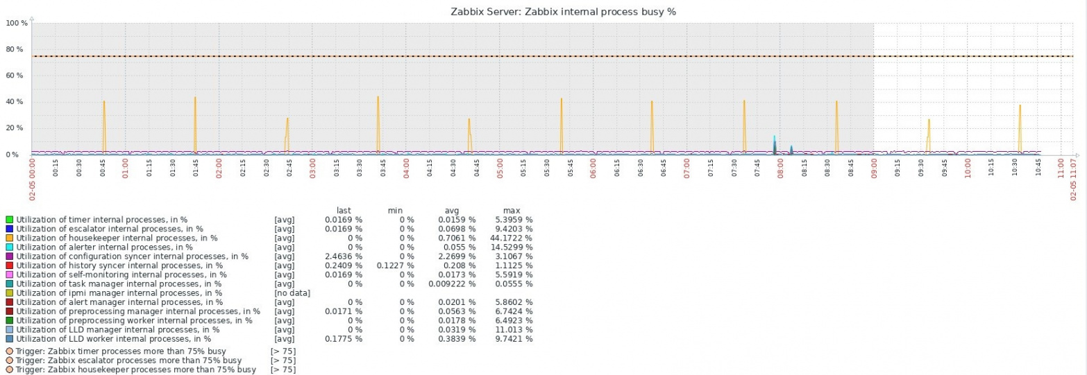

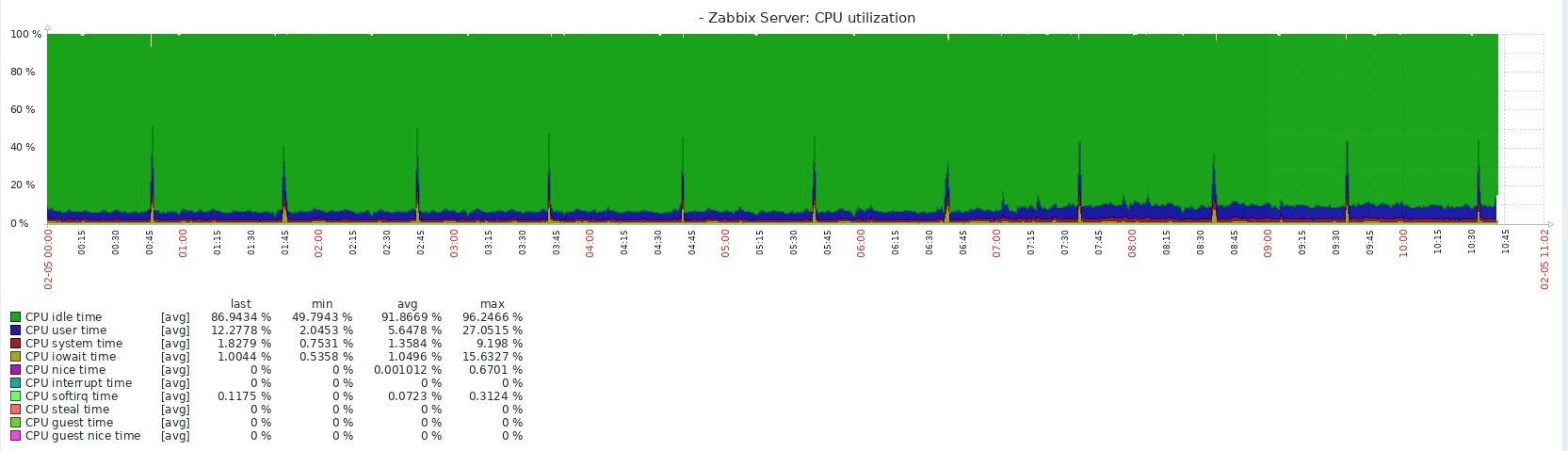

              I don't see any specific problem in the DB configuration with that amount of NVPS, you could try limiting the buffer pool size to 2 GB since you are running the Zabbix server there as well. What does your Zabbix server performance metrics say? There are useful graphs in the Zabbix server template.

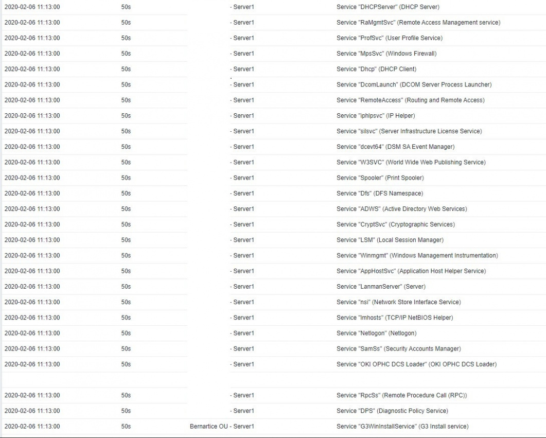

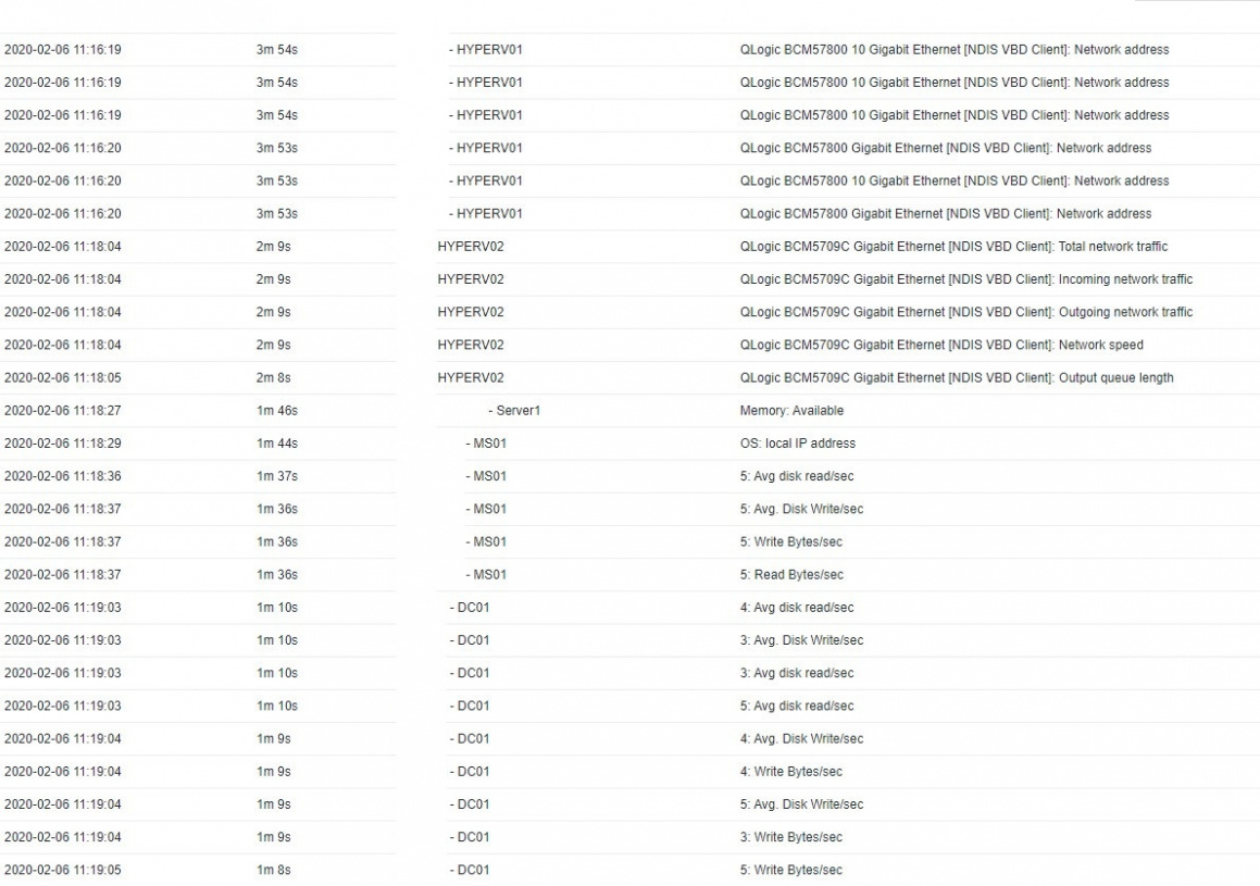

              Anyway, when thinking about the increasing queues with active agents, it basically means that either the agents haven't sent the item data in time, or the Zabbix server cannot process the data. In my experience it is mostly the former (agent side problem). What kind of items are you having in the problem hosts? Aren't the specific items listed in the queue details page? I don't remember the exact output, can you copy something here?

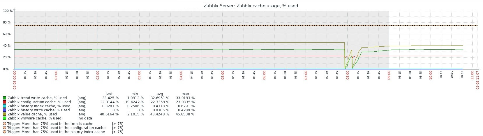

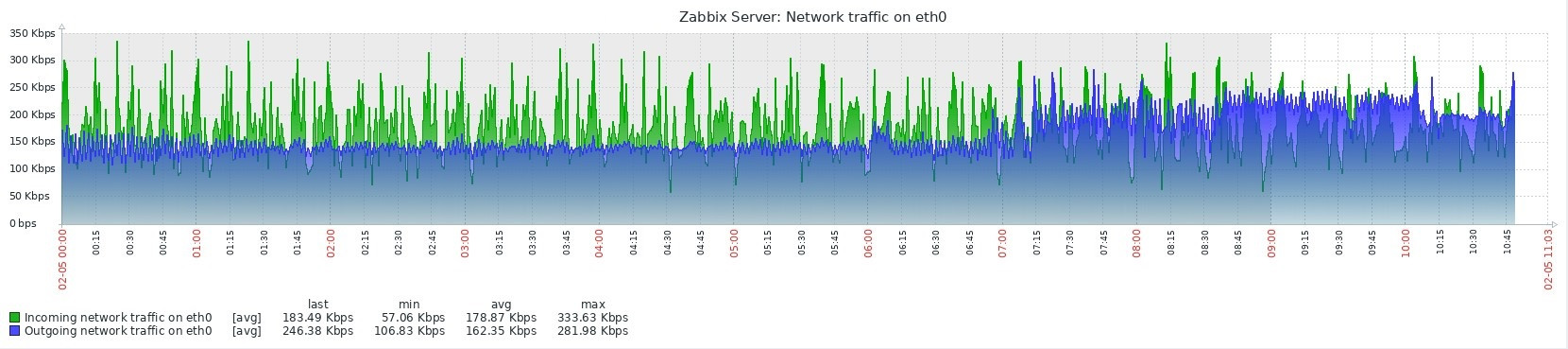

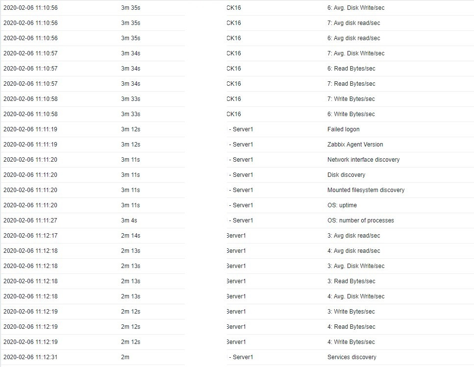

                I tried clean as much as possible items which is not supported. A lot of them was discovered network interfaces, so I created some exceptions.
                I add some pictures - graphs and queued items. A lot of them are items of disk performance, but there's something out of it all.

                  I was limited for 5 files in attachments so there are next 5.

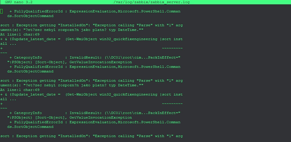

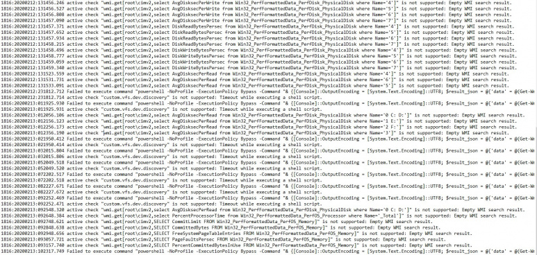

                        zabbix_server.log is full of informations about unsupported items - I think it´s ok.

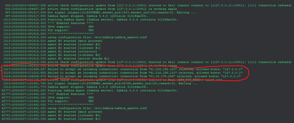

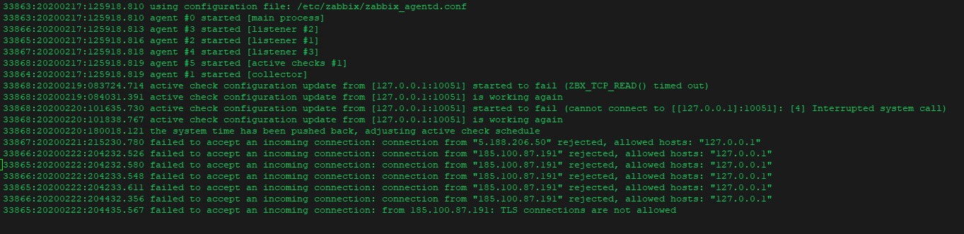

                        In zabbix_agentd.log on Zabbix Server I don´t see any problems - only some records look like attack. But I don´t know.
                        zabbix_agentd.log on Windows Hosts looks ok, there are only records about unsupported items.

                          Ok so you have lots of failing/unsupported items configured, if I understand this correctly. How about just removing the conflicting items to see what effect they contribute to you problems?
                          Also do note that your Zabbix server's agent log indicated a couple of times that the agent could not connect to your server (127.0.0.1:10051), that's not a good sign at all. That kind of situation would definitely cause the queues to increase: agents cannot connect to the server.

                            I don´t know why my agent could not connect to server. Server and agent is on the same host and server is still turn on. There is next screenshot from host (zabbix_agentd.log). There are some records with failed connect to server (localhost) and some connections from unknown public IP (attack?).
                            I still get many e-mails "Host did not recieve data" (.nodata trigger) and in queue tab is sometimes many delayed items. It is not items from one application but from some from every (network, disks, services, ...)

                              Based on the information you presented your Zabbix server is not able to receive the TCP connections from the agents.
