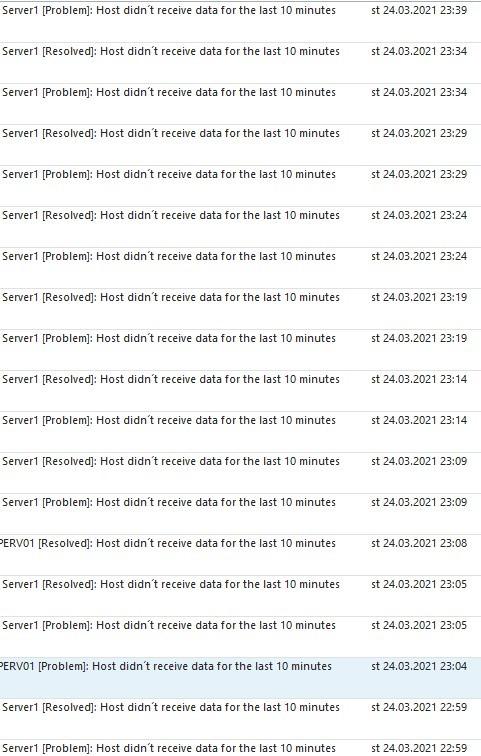

                  The main problem is that two hosts still starting one trigger, which sending e-mail.. So when I come to work, I have for example 300-500 mail messages per night. Screenshot from Outlook in attachments. We don´t have any bandwidth limit on Zabbix server.

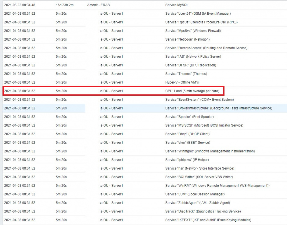

                          In attachments I add agent logs from both problem hosts. No errors, only sometimes timeouted one script which takes a long of time. And I add a screenshot when we could see (in queue tab) the delay of one problem host.

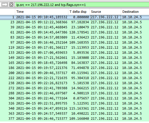

                                I filtered only the packets starting the TCP sessions (source = client, TCP has SYN bit on):
                                Click image for larger version  Name:	delay-pcap.png Views:	0 Size:	56.2 KB ID:	422878
                                In the delta display time column you can see very irregular intervals when the client is initiating the sessions. As there are lots of different items with different intervals being monitored, I guess that is normal.
                                Your connection is TLS-encrypted so we cannot see what data is exactly contained in the packets (so we don't know what happens with the CPU items that you are getting the delay problems). You may want to first remove all items from the host, then adding only some specific items (like the CPU) that don't include sensitive data, remove TLS encryption temporarily, and then repeat the packet capture to see what you get.
                                (Update, forgot to say: In the capture there isn't any indication of network problems that could explain your problems, as far as I see it)
