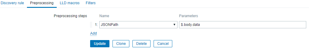

                  Click image for larger version  Name:	prepro.png Views:	0 Size:	5.7 KB ID:	395432
                • Use the JSON returned from the code to assign the LLD Macros.

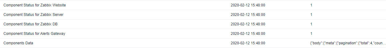

              The reult
              Click image for larger version  Name:	latest_data.png Views:	0 Size:	15.0 KB ID:	395431

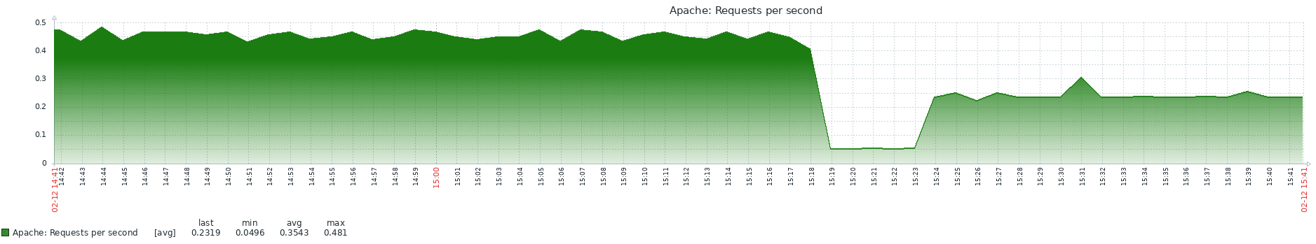

              The rationale for this
              Previously, I used a rather strait forward approach: A discovery rule and Prototype Items, all of type HTTP Agent. This approach resulted N+1 calls to the API agent (N being the number of discovered components). Having plans to significantly increase the number of components, I knew this would most probably bring the web server to a degraded performance.
              By implementing this query architecture, I was able to actually make just a single HTTP call to the API engine, to get the item data. An important offload.
              Click image for larger version  Name:	graph.png Views:	0 Size:	65.1 KB ID:	395430

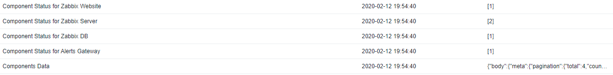

                          Well, it works, but return the value with the brackets.
                          I know I can left and right trim the value, but if that is the case, isn't that as expensive as running the javascript code?

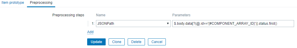

                            You can add .first() function to jsonpath, in this case no trimming will be required
                            • high-t
                              • Dec 2014
                              • 68
                              #15
                              Works like a charm
                              Click image for larger version  Name:	item.png Views:	0 Size:	11.4 KB ID:	395461
                              Click image for larger version  Name:	latest_data.png Views:	0 Size:	15.3 KB ID:	395462
                              So this syntax is new to me:
                              $.body.data[?(@.id=='{#COMPONENT_ARRAY_ID}')].status.first()
                              Does this means: For each item in the array "data", where the value of "id" equals the value of the LLDMACRO , return the first value of "status"?
                              Man.. this thing is complicated...
