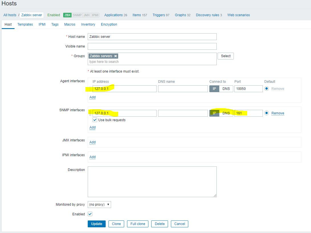

                          You showed a screenshot above with the SNMP interface area circled, but would it be possible for you to screenshot exactly what you're filling in after you click the "Add" link? Basically, before you click "Update", screenshot what you've configured in the SNMP Interfaces area. Please provide that.

ID:	395942 so here is output of snmpwalk from command prompt of Zabbix server I have hiddent my server name.

                              Thanks for providing that additional information. I wish I could tell you that I see something wrong with your config, but I don't.
                              The only thing that's different between your system config and mine is that for the SNMP Interface, I'm using the public IPv4 address for our Zabbix server, rather than 127.0.0.1. I too have "Use bulk requests" checked (which I don't think makes any difference in the case where we're defining an interface where we want to receive traps; bulk requests should only make a difference if that interface is used for SNMP polling). I'm also using "IP" rather than "DNS" for this interface, and still using port 161. Note that port 162 (not 161) is the SNMP trap port, but that too doesn't matter in this case.
