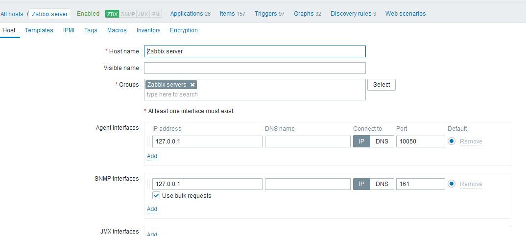

            #20
            i dont know whaht made me do this but i tested in firefox and i was able to add it !! but still snmp is not enabled Click image for larger version

            • rajsolanki
              • Feb 2020
              • 46
              #21
              well my traps are working this has been fun Thanks for all the help. Seems like it was browser issue
