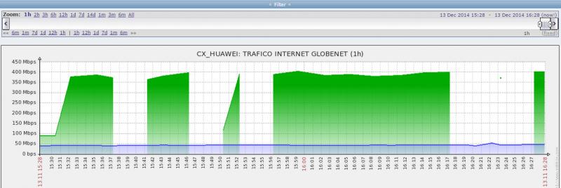

    Zabbix Graphs Problems, are being cut.
    I have a problem with Zabbix Graphs continuously. The graphs are being cut. Please view the attached image. Help, any ideas. Thanks.
    This is my Zabbix status.
    Zabbix server is running Yes localhost:10051
    Number of hosts (monitored/not monitored/templates) 102 59 / 1 / 42
    Number of items (monitored/disabled/not supported) 12422 12301 / 0 / 121
    Number of triggers (enabled/disabled) [problem/ok] 1823 1823 / 0 [1 / 1822]
    Number of users (online) 4 2
    Required server performance, new values per second 118.06

    This looks like your "green" item is becoming unsupported from time to time, or the host is loosing connection so the item doesn't fetch the data when it should.
    Could you open that item only in latest data and select Values in the upper right corner and post a screen shot here. Also check the zabbix_server.log if there are any connection problems on that host or maybe some item is timeouting and causing other items to fail.

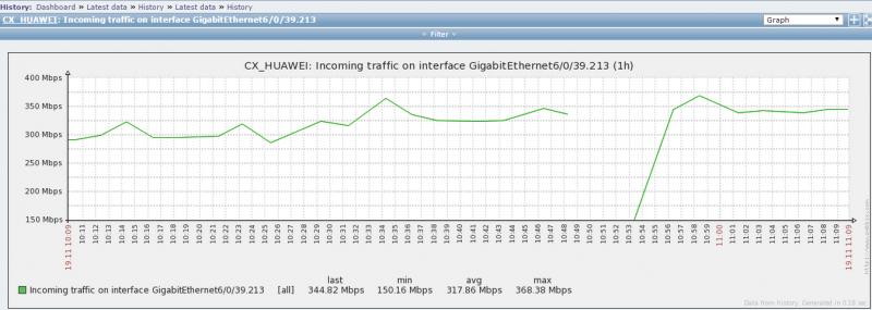

      Here the values and graph in the latest data. In the zabbix_server.log there aren't any connection problems. Thanks.
      Timestamp Value
      2014.Nov.19 11:06:27 338822320
      2014.Nov.19 11:03:25 342752568
      2014.Nov.19 11:01:28 338968312
      2014.Nov.19 10:58:29 368383968
      2014.Nov.19 10:56:30 345377256
      2014.Nov.19 10:53:27 150161224
      2014.Nov.19 10:48:22 336227160
      2014.Nov.19 10:46:30 346405616
      2014.Nov.19 10:43:24 324755592
      2014.Nov.19 10:41:31 323735152
      2014.Nov.19 10:38:21 324942816
      2014.Nov.19 10:36:29 334845680
      2014.Nov.19 10:34:24 363285392
      2014.Nov.19 10:31:29 316522280
      2014.Nov.19 10:29:26 324228192
      2014.Nov.19 10:25:31 285966776
      2014.Nov.19 10:23:21 318634280
      2014.Nov.19 10:21:28 298119320
      2014.Nov.19 10:18:25 295365872
      2014.Nov.19 10:16:32 294724712
      2014.Nov.19 10:14:26 321956320
      2014.Nov.19 10:12:25 298445016
      2014.Nov.19 10:10:29 291307496
      2014.Nov.19 10:08:26 307416656
