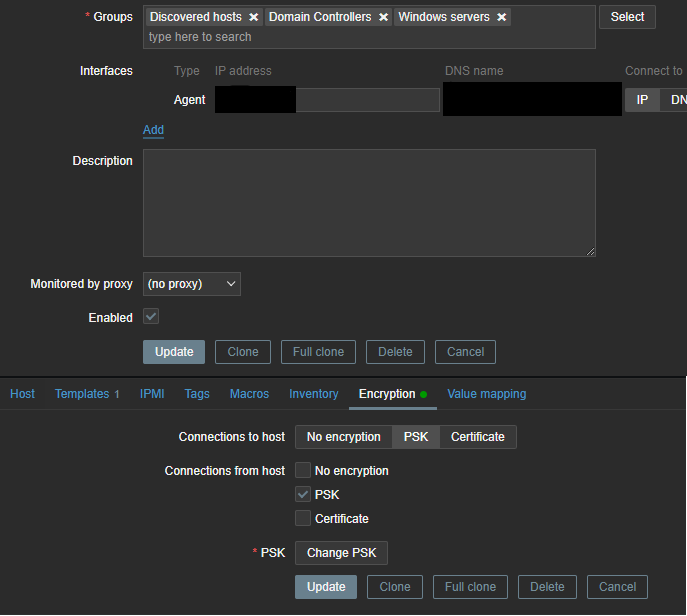

          • maha
            • Jan 2022
            Yep, host is configured with correct IP and Agent ifc. PSK is selected on both encryption directions. See attached image.

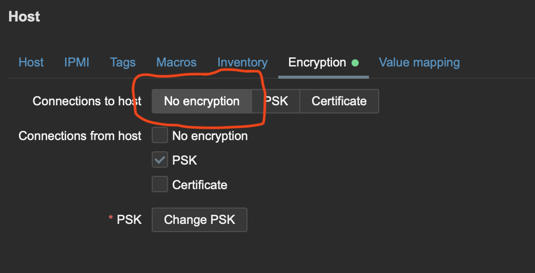

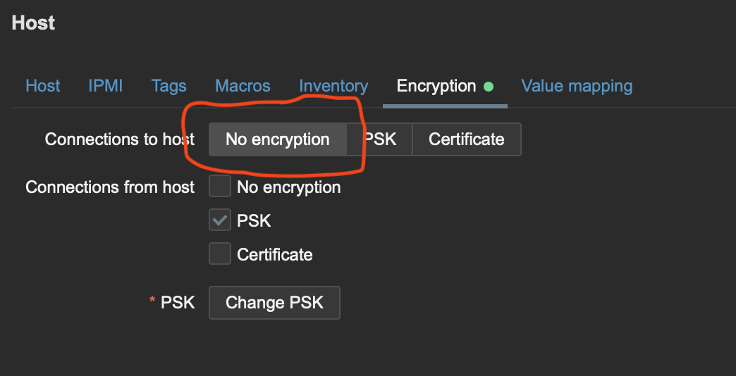

                  I realize this is an ancient thread but was running into a situation where the encrypted connection was working, but it was throwing the "unencrypted connections are not allowed" errors in the agent log, and the host was showing as 'Unavailable'. Though data was being sent.
                  Just an aesthetic problem but turns out you can select "No encryption" on the host even when you have encryption set up. Once you click on "PSK" the errors go away.
