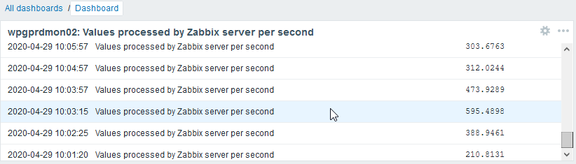

        Thanks for your comment. Here is a screenshot of my values per second maximum reached about 595. how would i determine the Start Pollers from this value?

          The appropriate value cannot be derived by simple calculations, as the time taken for each item will vary. Repeat changing the value of StartPollers and checking the busy rate, and try adjusting it so that it is 70% or less.

            So i changed StartPollers to 10 on the server and the proxies. That seemed to work. I noticed values per second is now peaking at about 425 now not as much as 500.
            Will keep an eye on things.

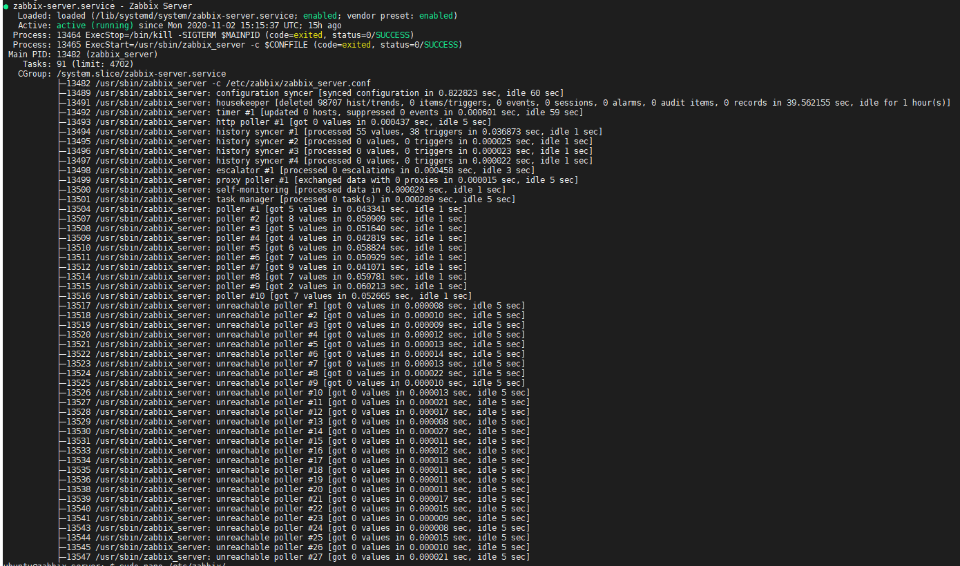

                Hello Everyone ,
                I am using zabbix v 5.0
                Host configured = 85
                items: almost 80-90 for each hosts (passive)
                I am having alert ; Zabbix trapper processes more than 75% busy and Zabbix discoverer processes more than %75 busy then It caused to zabbix is not running even systemctl status zabbix-server is" active ".After zabbix-server.service restart , In dashborad zabbix server status is running but after for a while status changed as "not running"
                I attached output of zabbix systemctl and zabbix-server_log
                Anyone can help me ?

                • avidec87
                  avidec87 commented
                  Hi Faith,
                  I hope you issue should be fixed by now but just for other reference, you need to monitoring your discovery period defined inside the discover. It should be 1 hour or more. Generally if somebody changes the discover timeperiod for a shorter time period for testing such as minutes or seconds and forget to update then it will create issue which you are seeing in your environment.
