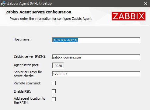

    Hi!
    I'm aware this post is over a year old but I came across it whilst struggling with the same issue and haven't seen the answer posted anywhere else. It looks like you were very much on the right track. In the Property table I just add a new line with the Property name as SERVER and a Value of the server IP or FQDN.
    You can then test the install interactively as you suggest: msiexec /i zabbix_agent.msi TRANSFORMS=mytransform.mst"
    You should see the server field pre-filled. You can then install using the quiet option or via group policy.
    I've attached a couple of snips showing this.
    Hope you got it sorted!
