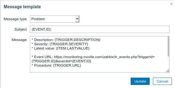

      The solution to the problem is:
      If you use any other subject, this will result in a problem.
      Apparently the problem is in Opsgenie API.

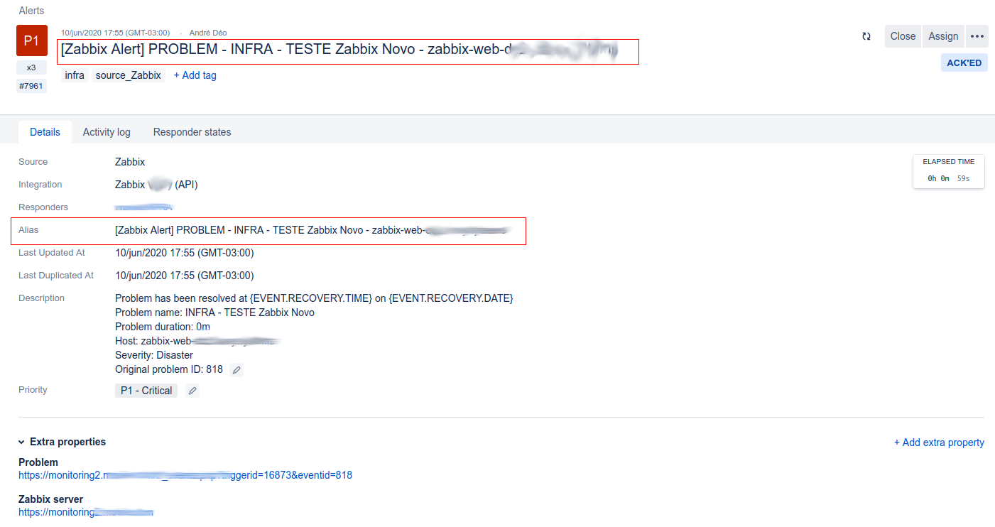

      But, after the OpsGenie processed the message, the result is:
      The alias field turns equal to the title.
