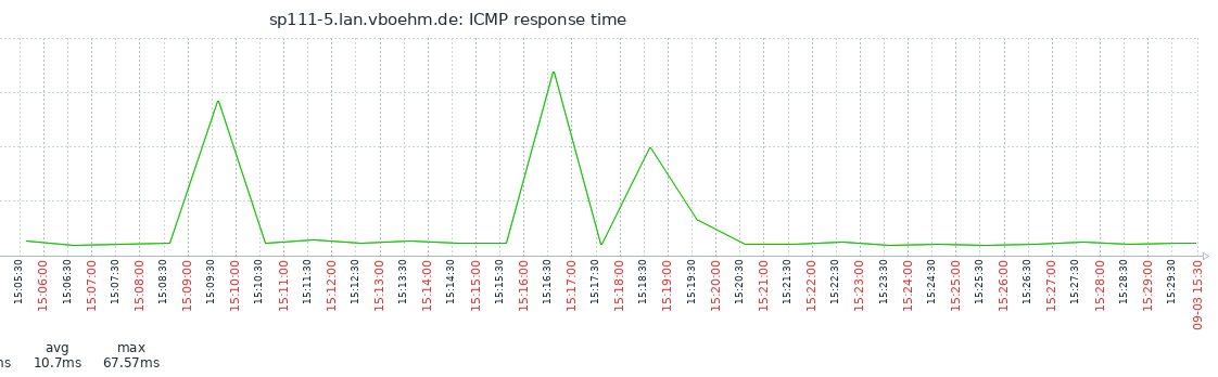

                  And why is this host availability still 'Unknown' though I get results for all Items?
ID:	408427Click image for larger version
