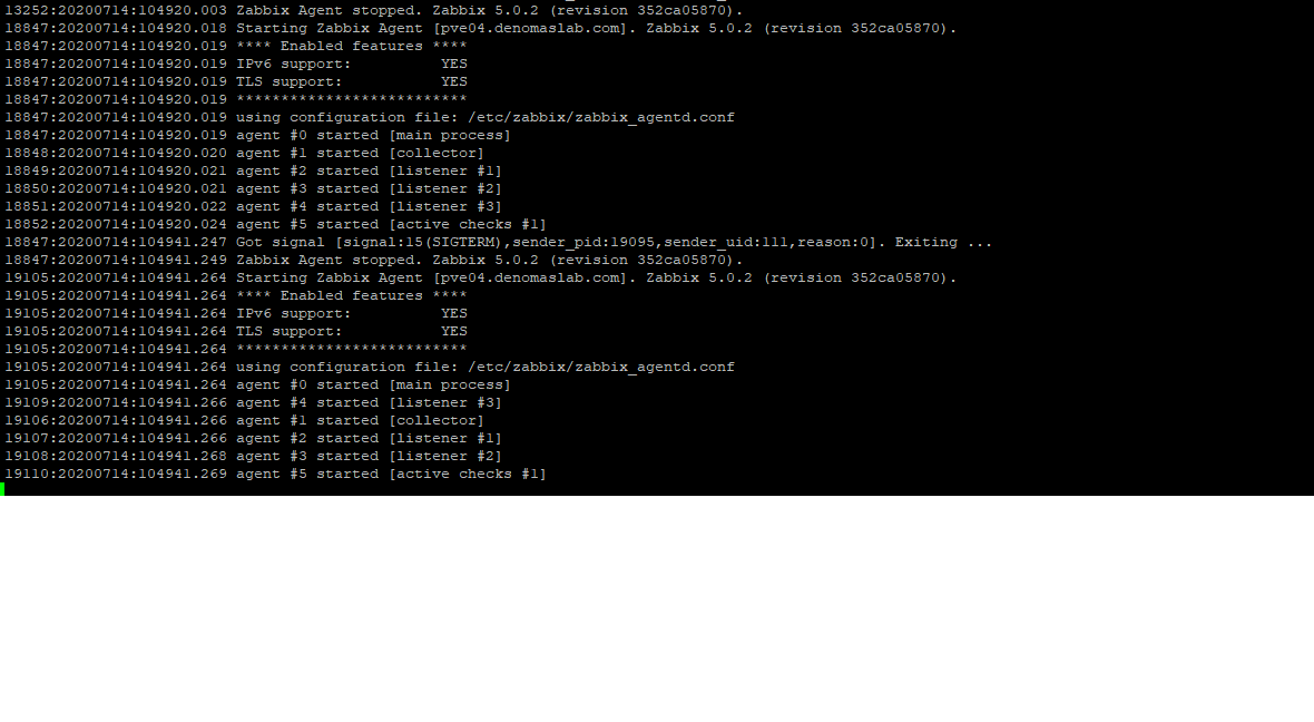

    agent zabbix agent log
    20171:20200713:184311.447 failed to accept an incoming connection: connection from "127.0.0.1" rejected, allowed hosts: "192.168.1.249"
    20171:20200713:184319.837 failed to accept an incoming connection: connection from "127.0.0.1" rejected, allowed hosts: "192.168.1.249"
    20169:20200713:184321.458 failed to accept an incoming connection: connection from "127.0.0.1" rejected, allowed hosts: "192.168.1.249"
    20170:20200713:184808.360 failed to accept an incoming connection: connection from "127.0.0.1" rejected, allowed hosts: "192.168.1.249"
    20170:20200713:184810.718 failed to accept an incoming connection: connection from "127.0.0.1" rejected, allowed hosts: "192.168.1.249"

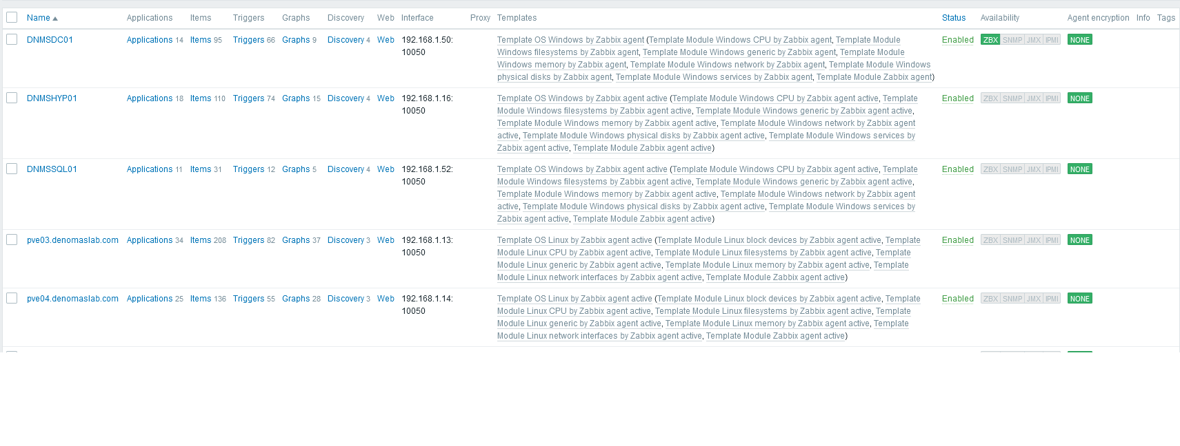

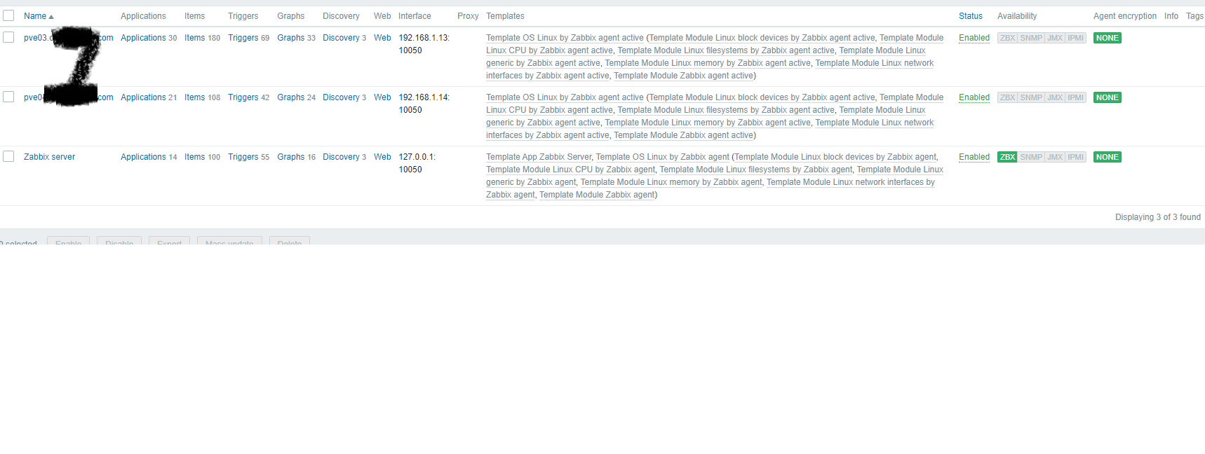

      agent is a different machine.
      I am currently watching 2 agents with active control. however, it is not lit green. Is this normal?
      no firewall, no extra settings, or no blocking.

        Please show me the Zabbix agent logs on the monitored server.

      passive trace with green light
      active monitoring without green light
      no errors in log files

        If you only have an active check, it will not turn green.
