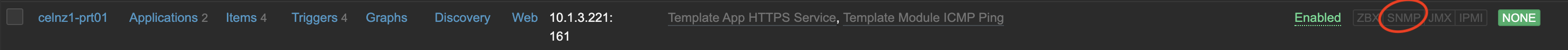

    4. I've manually configured 4 hosts in Zabbix to use SNMP, the community string in the Zabbix macro and on the device itself is "public".
Name:	Screen Shot 2020-07-15 at 18.42.42.png

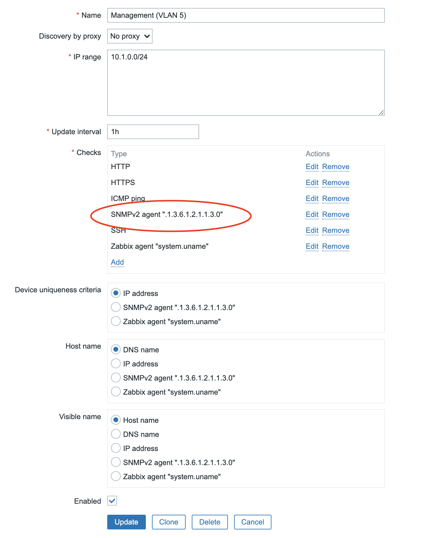

  • mike548141
    • Jul 2020
    I ended up deleting the appliance and starting again. Eventually got it working, but I think what made the difference is adding SNMP to the discovery checks
Name:	Screen Shot 2020-07-18 at 17.21.23.png
