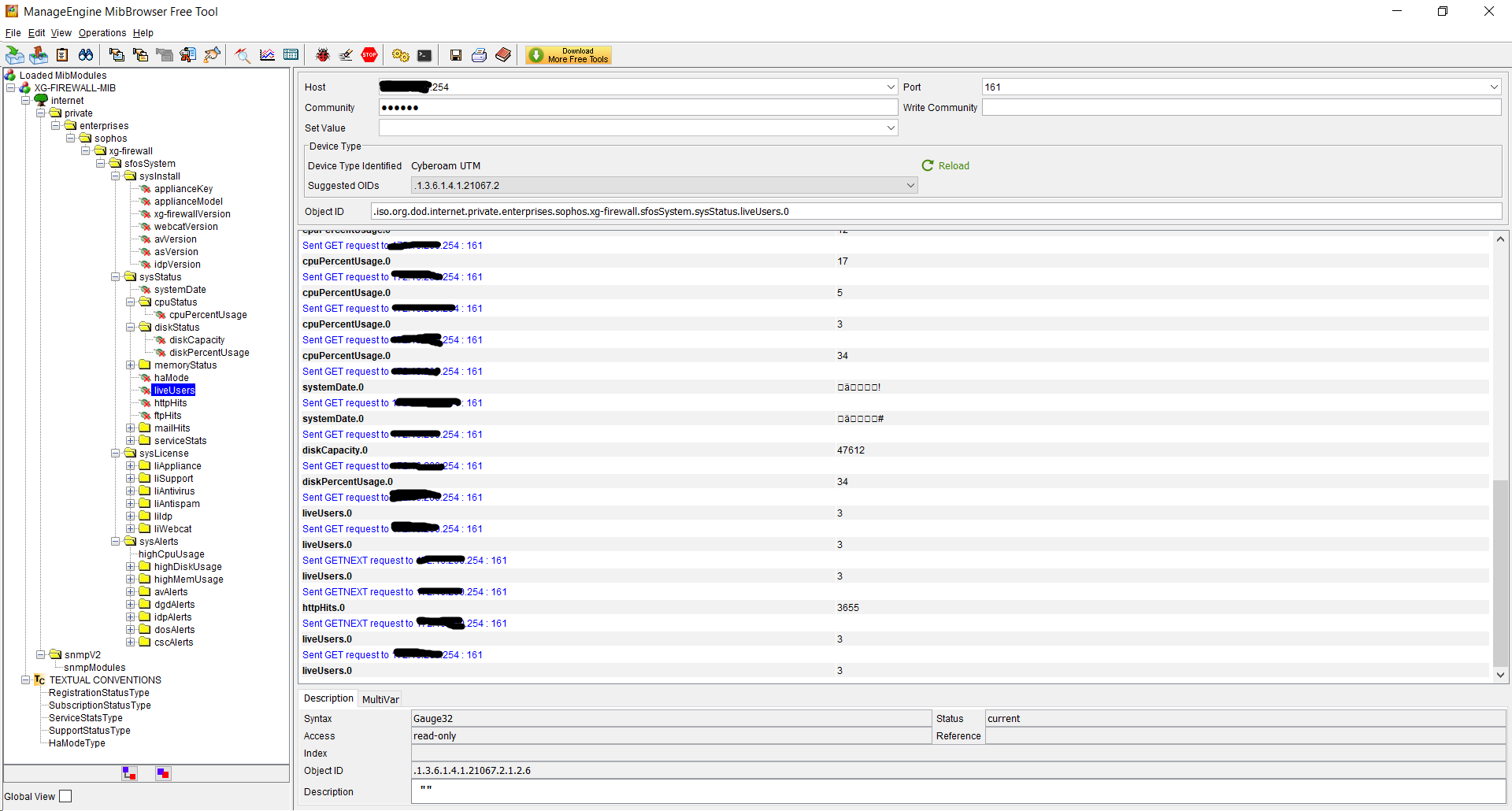

    Im trying to create new SNMP items for Sophos XG, im using "ManageEngine Mib Browser" the read the mib file and get OIDs.
    In ManageEngine Mib Browser everything works. but test the item in zabbix it show the error message "Timeout while connecting"
    This is a screenshot from ManageEngine Mib Browser:
    Click image for larger version  Name:	1.png Views:	0 Size:	179.5 KB ID:	406332

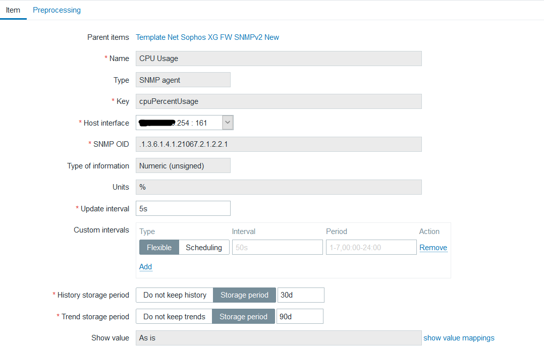

    This is a screen shot from Zabbix 5:
    Click image for larger version  Name:	2.png Views:	0 Size:	39.1 KB ID:	406335

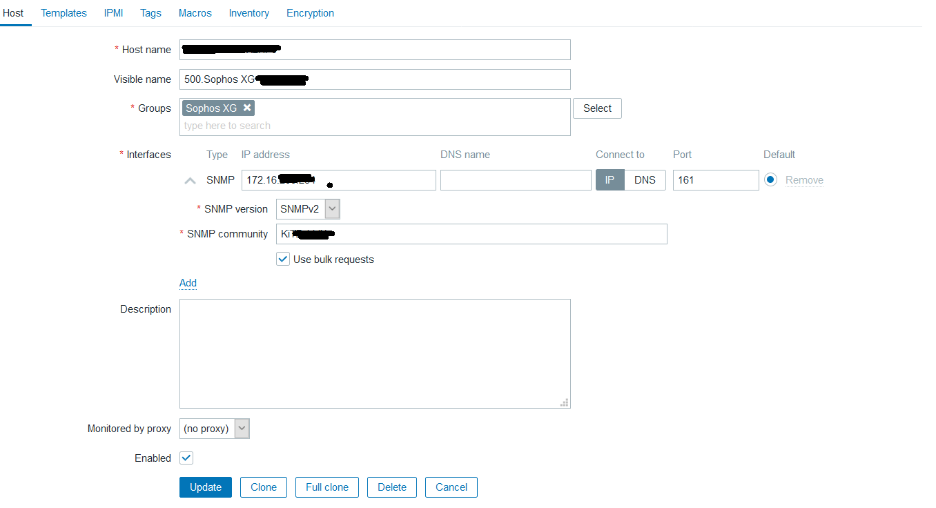

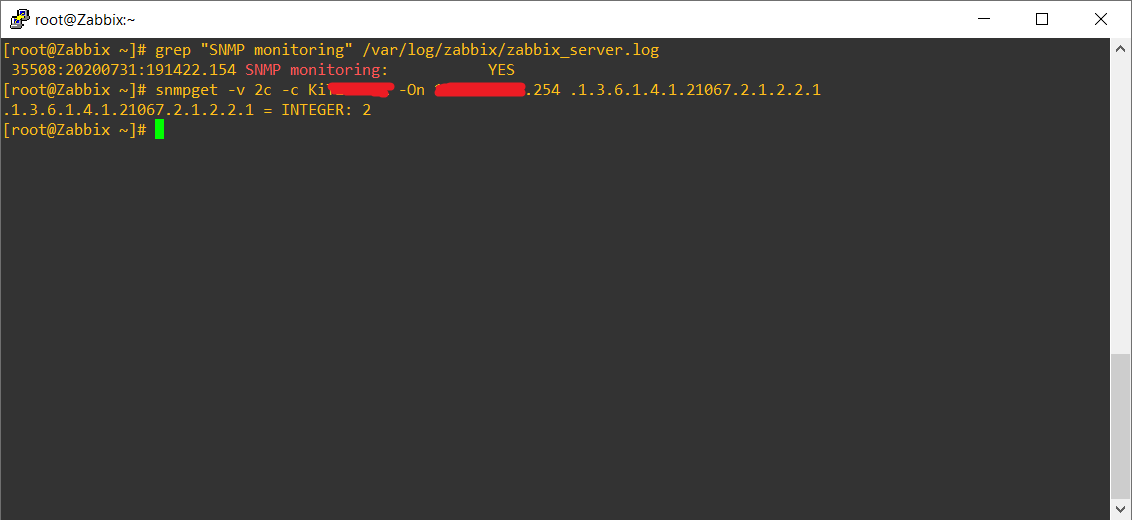

    Checking SNMP monitoring is enable and test the OID by snmpget:
    Click image for larger version  Name:	5.png Views:	0 Size:	18.9 KB ID:	406336

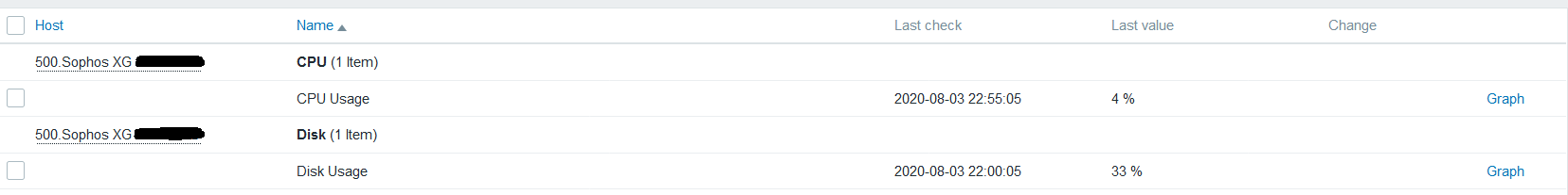

      You can check the first pictures now, i tried to check last data and found that Zabbix get this item last data well.
      so just the item test who doesn't work.

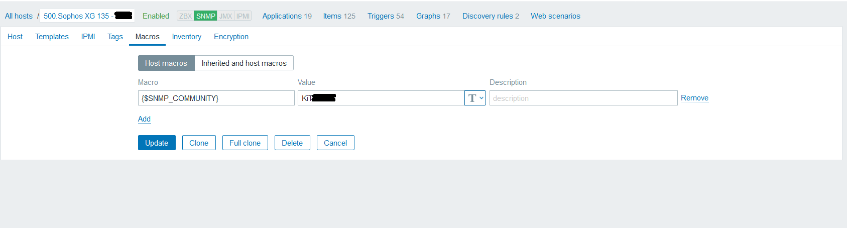

        this is a printscreen for host macros.

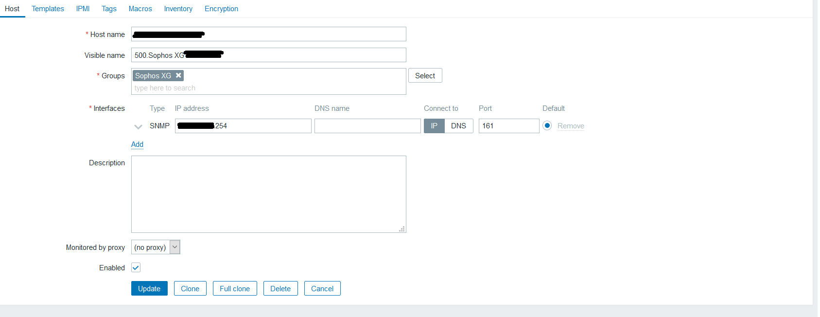

          Show the configuration of the SNMP interface for this node.

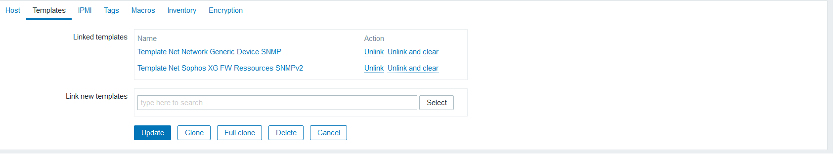

            This is host SNMP config:
            This is last data check:

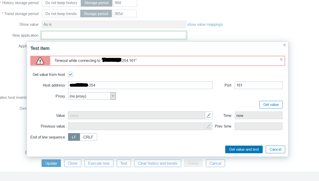

                ManageEngine Mib Browser: Works well
                snmpget: Works well
                Last data (Zabbix GUI): Works well
                Test item: Not working

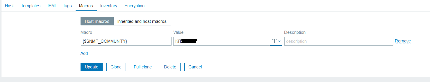

                    Super quick testing on two hosts says to me that when testing an item, the macro for SNMP community is not parsed.
                    I tested a host where the SNMP community was set on the host and the item tested fine.
                    I tested on a host where the snmp community is set to {#SNMP_COMMUNITY} and it failed
                    • Noobz
                      • Jun 2020
                      • 105
                      https://support.zabbix.com/browse/ZBX-17886 - This ticket will resolve the issue we are seeing.
                        i tried to set the SNMP community on the host, the problem fixed.
                        thanks.
                        if someone has the same problem, just put the community directly in host.
