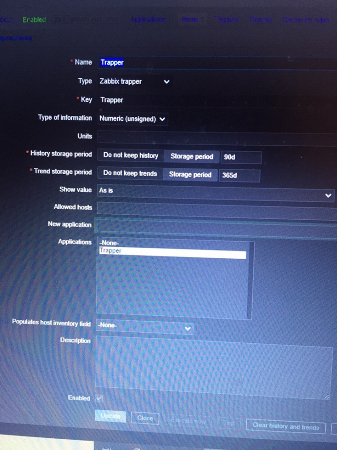

    I have created an item that use zabbix_trapper .
    I have just installed zabbix-sender-5.0.2-1.el7.x86_64.rpm on the host now when run zabbix_sender command such as follow pic not work correctly . what is the issue?
    Click image for larger versionName:	Image-2.jpgViews:	0Size:	264.5 KBID:	407552

      It would be nice to have a proper screenshot where we can see details better.
      Make sure you are able to connect to Zabbix server from the host where you run zabbix_sender:
      telnet 10.10.50.23 10051
      If not, it could be a firewall issue or Zabbix server could be started on a different port from 10051. Or, it wasn't started at all.
