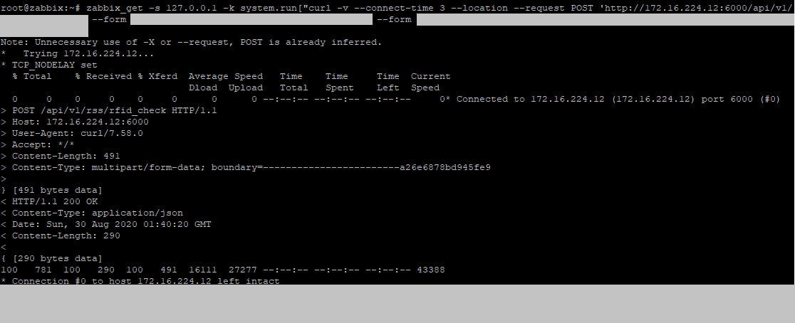

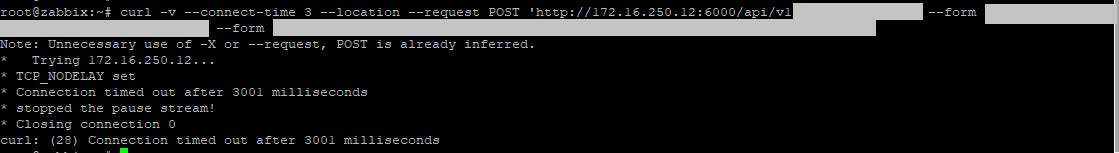

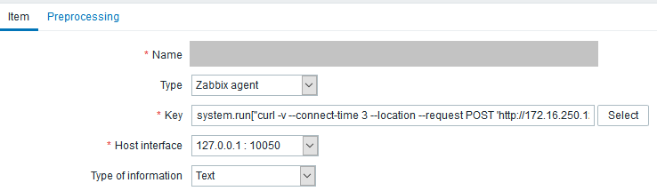

    I've tried both execute shell script call curl using zabbix_agent User Parameter and remote command give same result "ZBX_NOTSUPPORTED: Timeout while executing a shell script."
    For successful command did not give any issue. But when i test connection timeout, error will always occurs.

      i'm using 4.4.9. I'm ok with error from curl when it come to time out, but i need it to get pass to zabbix.

        Ah, now I see the problem... This timeout isn't from cURL man... it's from Zabbix-server... your script took more time than Timeout server configuration (Default is 3 seconds) to respond:
        https://www.zabbix.com/documentation.../zabbix_server
        Timeout no 1-30 3 Specifies how long we wait for agent, SNMP device or external check (in seconds).
        You can set a higher time (to a max of 30 seconds) but I don't recommend it.

          thank bro, its work now. I set 5 second timeout in zabbix agent config file. thanks.
