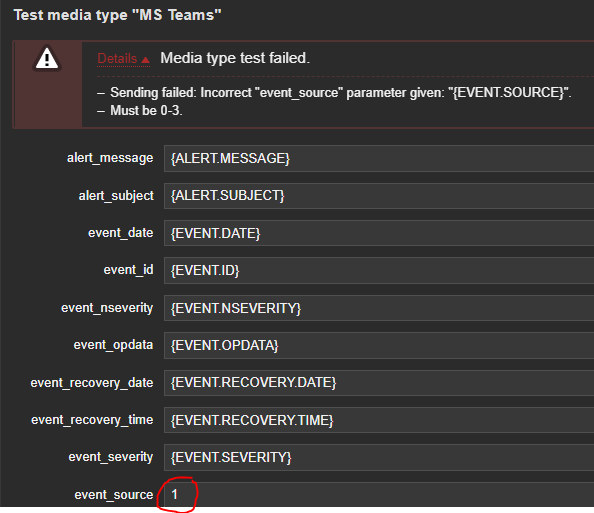

    I have a problem when I want to perform a test of the Microsoft teams configuration in zabbix, it notifies me this error:
    Media type test failed.
    • Sending failed: Incorrect "event_source" parameter given: "{EVENT.SOURCE}".
    • Must be 0-3.
    I would appreciate your help, thank you very much

    I am also getting the same issue in my zabbix server.
    Can anyone help to resolve this issue.

      Just enter '1' as below, should then work providing you have configured webhook the test should work ;

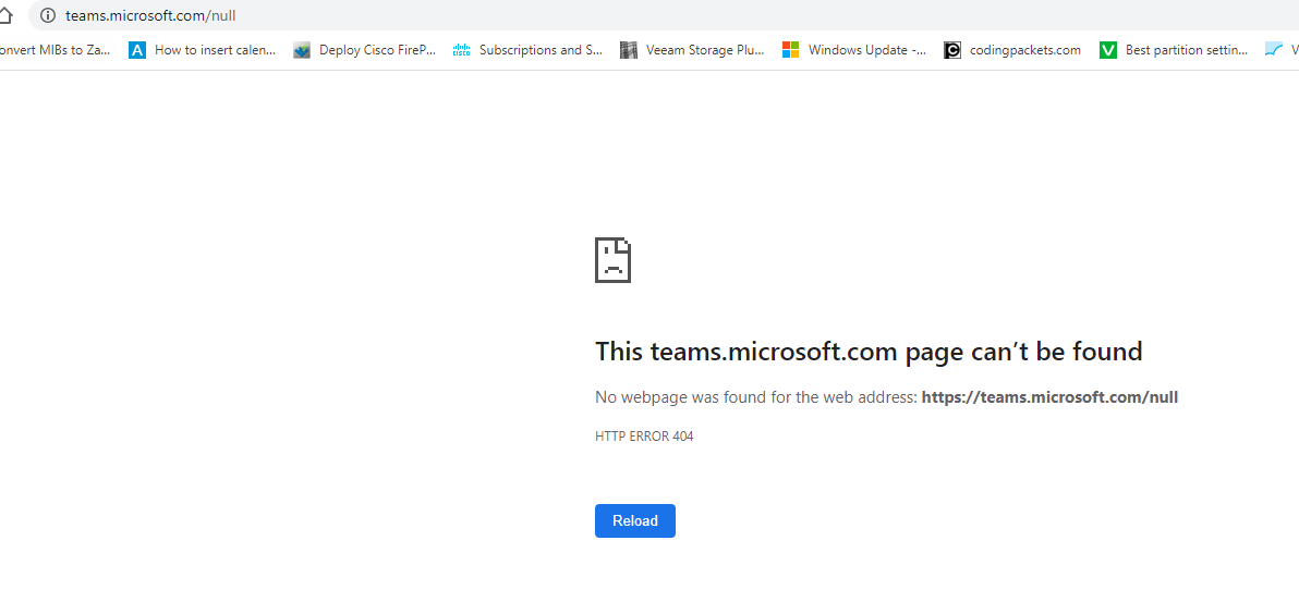

      The button takes me to;
      Even after I have specified the {$ZABBIX.URL} within General -> macros. Would be good to get feedback if others find this works.
